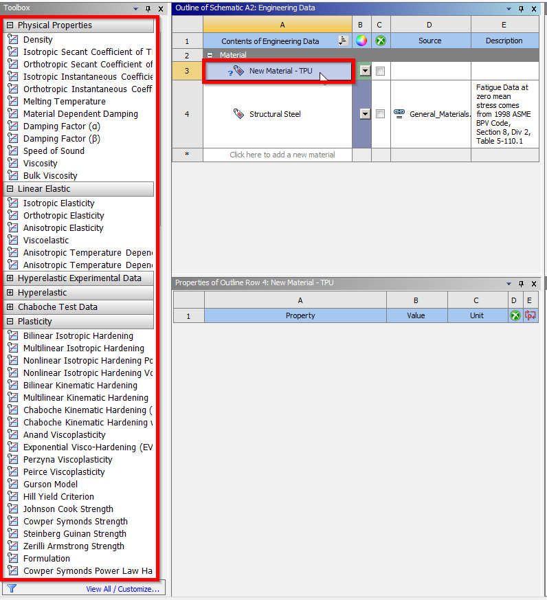

      Once going into the Engineering Data tab, you can add the name for new material and you can drag and drop the required properties from the Toolbox panel.
      Another way can be duplicating the closest available material to TPU and renaming the same and updating the properties to the renamed material.
      Please find the following image to get an idea of the same-
      Please refer to the following link for more insights- Creating a New Material (ansys.com)
