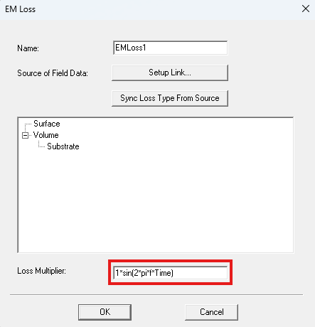

      1. Is there a way to implement a time-dependent variation, specifically a sine variation, on top of the EM losses computed from HFSS, while running an electrothermal simulation in Ansys Icepak AEDT?
      2. Is it correct to include an expression of a sine function like sin(2*pi*f*Time), with f = 217 Hz, directly in the loss multiplier field?

      3. Assign an EM loss Boundary Condition (BC) to the dielectric. A link between HFSS & Icepak is created. In the loss multiplier field, I add a sine function as shown in the screenshot below.

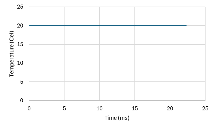

          4. I add a monitor point on the top surface of the dielectric to check the temperature rise over time.
          5. Create a solution setup, generate mesh, and run the simulation. Simulation runs from 0s to 23ms in time steps of 0.18ms. The resulting temperature over time is shown below.
