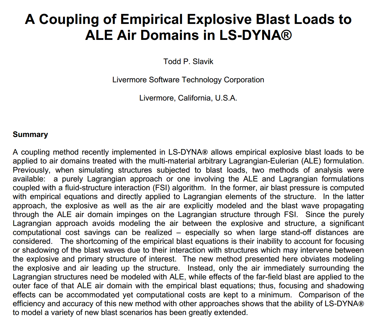

      I have noticed that LS-DYNA currently provides an integrated LBE+ALE approach, which can more efficiently handle obstacles in air blast simulations. Based on this, I wonder whether the same method could be applied to analyze underwater explosions? In the LBE method, the blast pressure data is derived from the historical CONWEP air blast database. If I have corresponding underwater explosion data, could I use user-defined functions to implement underwater explosion analysis?
