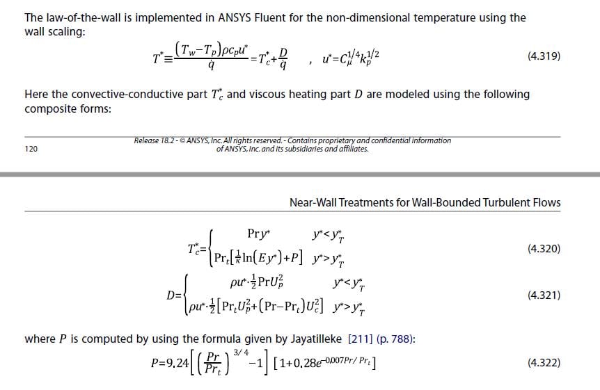

      Thanks for helping. The wall boundary condition I used is adiabatic wall, so I cannot use HTC = (wall temp - wall adj temp) / (-k * dT/dn). I need to get the HTC wihch is calculated based on wall function (see the attached figure).
      I am dealing with the simulation of ice accretion now, in which case there is a thin water film on the solid surface. I assume the HTC between air and water film is equal to that between air and solid wall. And I need to use the HTC between air and water film to calculate the mass of froozen water.

      Couple of questions:
      • Which version of Fluent are you using?
      • I was just checking the Fluent users and theory guides for v18.2. Could you please verify and confirm if this is what you want? I am posting screenshots from the Users and Theory guide here.
      From Users Guide:
      From Theory guide:
      Thank you.

      Hi I am using 18.0. The formula you posted is what I want. However, is there any macro I can use to get HTC directly? Thank you.

      Hi I have not found out how to use the FLX_C_WALL_FUNCT_BASED_HTC. Instead, I calculated the HTC based on the wall function by myself with the formular provided by the help document.
