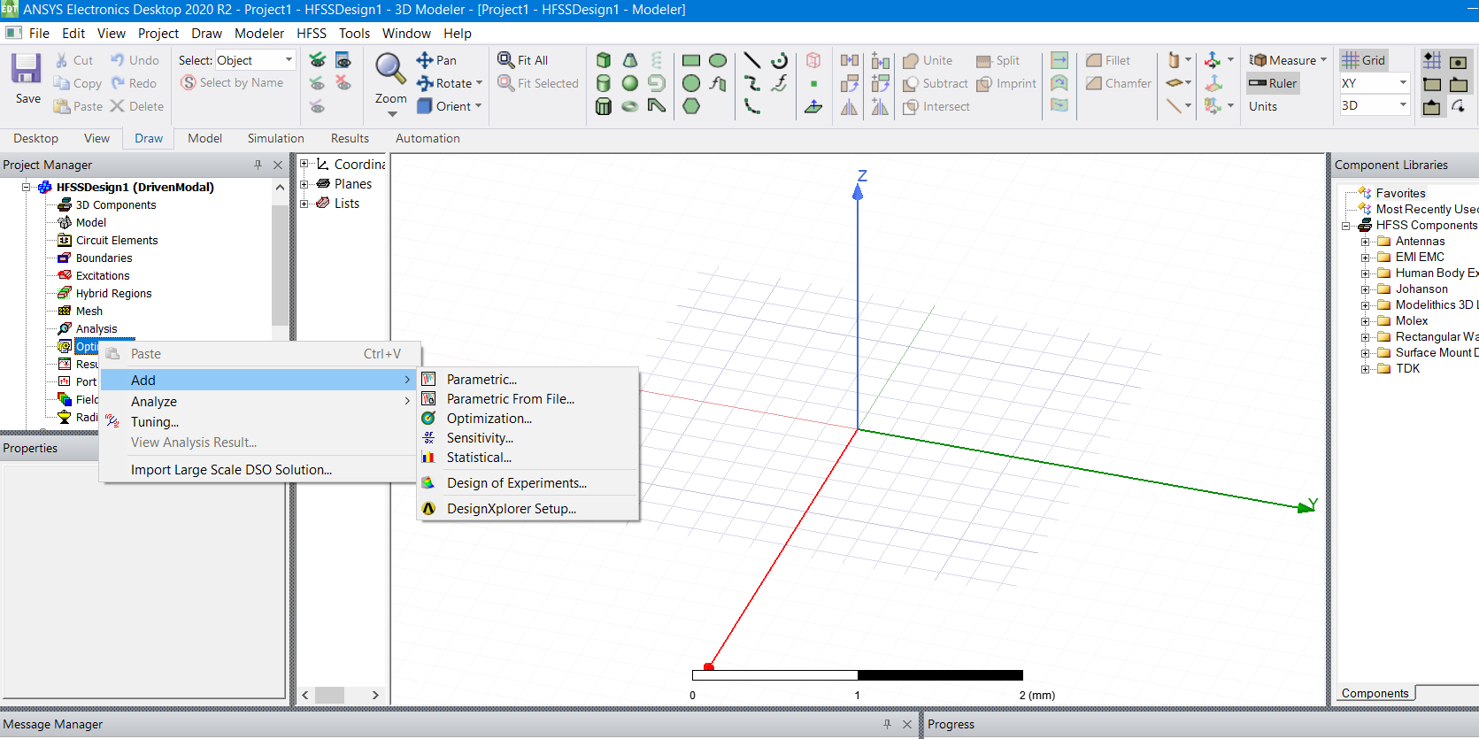

      I wanted to use Ansys optisLang for my antenna design optimization. I am using a licensed version of Ansys Electromagnetic Suite 2020 R2, which has been purchased by my institute, and I have designed my antenna using HFSS.
      I have tried looking for optisLang in the ACT extensions, but was not able to find the same. Please find below a screenshot of the ACT extensions that I have with my license.
      Please help.

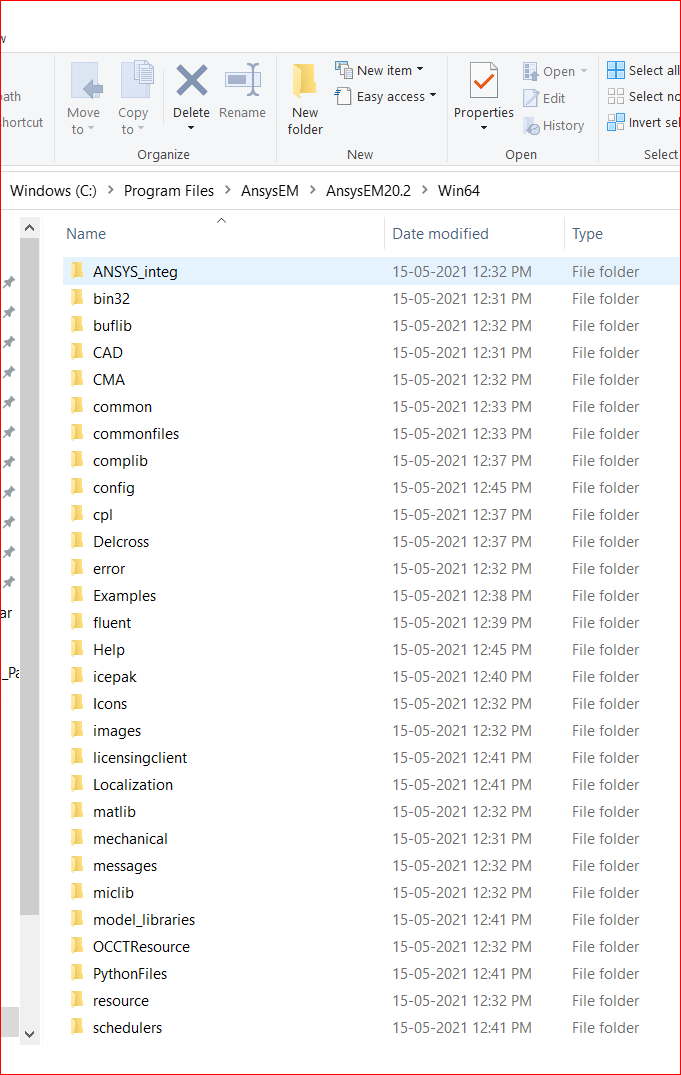

      Dear Sir I am not able to find the .log file in the suggested path. I even did not find any folder named Ansys Inc.
      Further, I tried searching .log file in the path C:\program files\AnsysEM\AnsysEM20.2\Win64, but I did not find the same. Please find the screenshot of the said path.

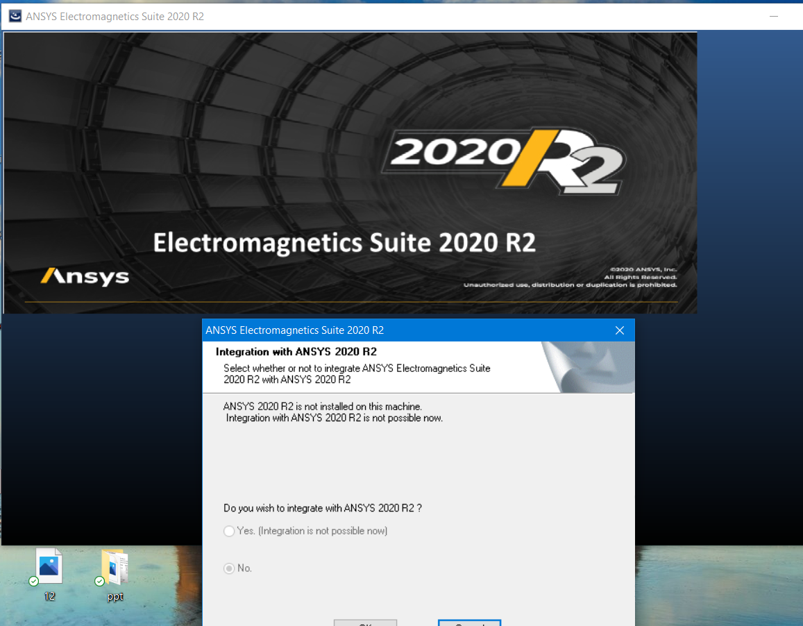

      I am even not sure whether the workbench has been installed or not. This is because when I try to integrated the Ansys Electromagnetic Desktop with the Ansys workbench (as mentioned in the Help document), the following message appears.

      Preeti Workbench 2020R2 is a separate download and install.
      When installing Workbench, you will need to choose Optislang to be installed when choosing from the list.
      From the Customer Portal Download page choose version 2020 2 to download structures package. This will give you Workbench 2020 R2
      Extract to temp directory and run setup.exe by right-clicking it and choosing run as administrator.
      When the list shows up, Check that OptiSlang is chosen and proceed
      After install is finished then run Modify Integration with Ansys 2020 R2
      This should integrate Electronics Suite with Workbench.

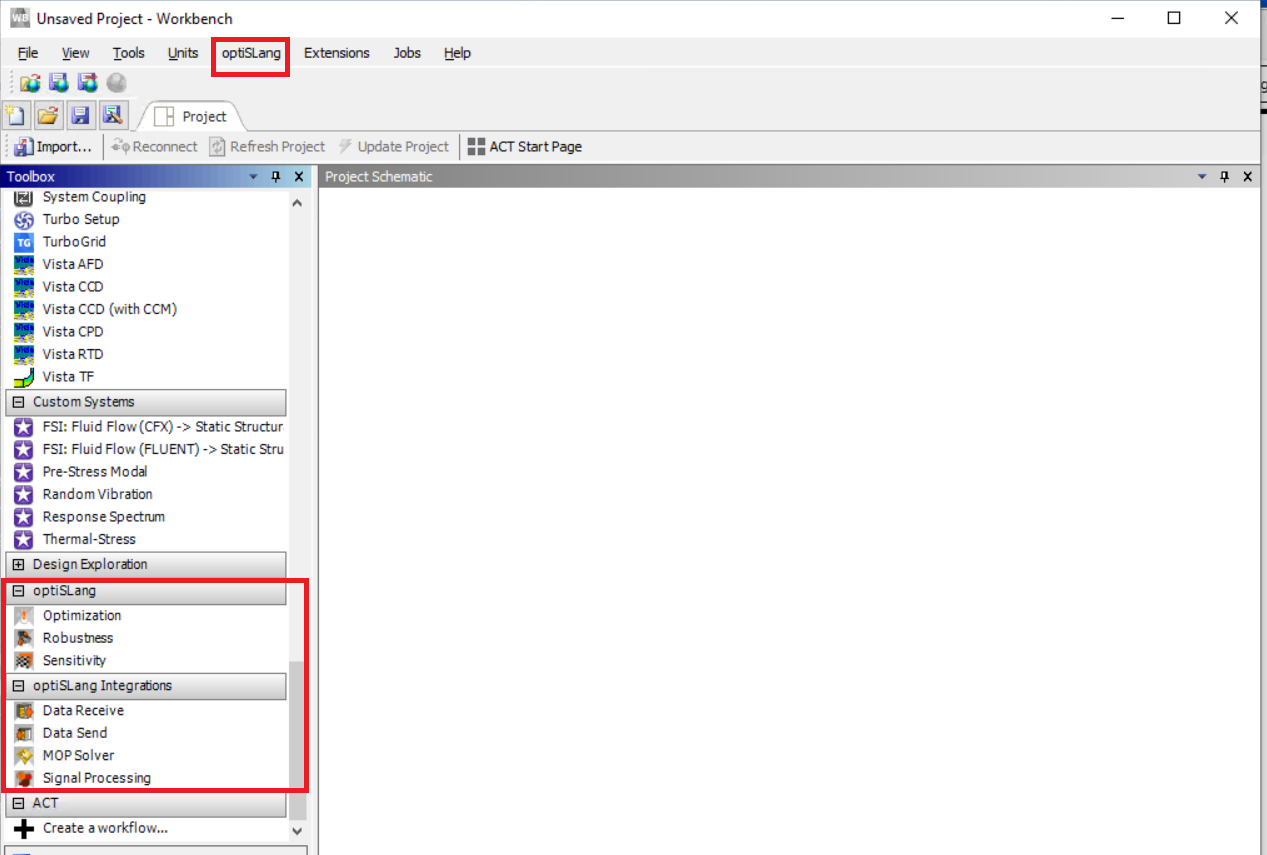

      After opening Workbench, you should go to Extensions->Manage Extensions
      Check OptiSlang and it should now show on the Workbench Project Page.

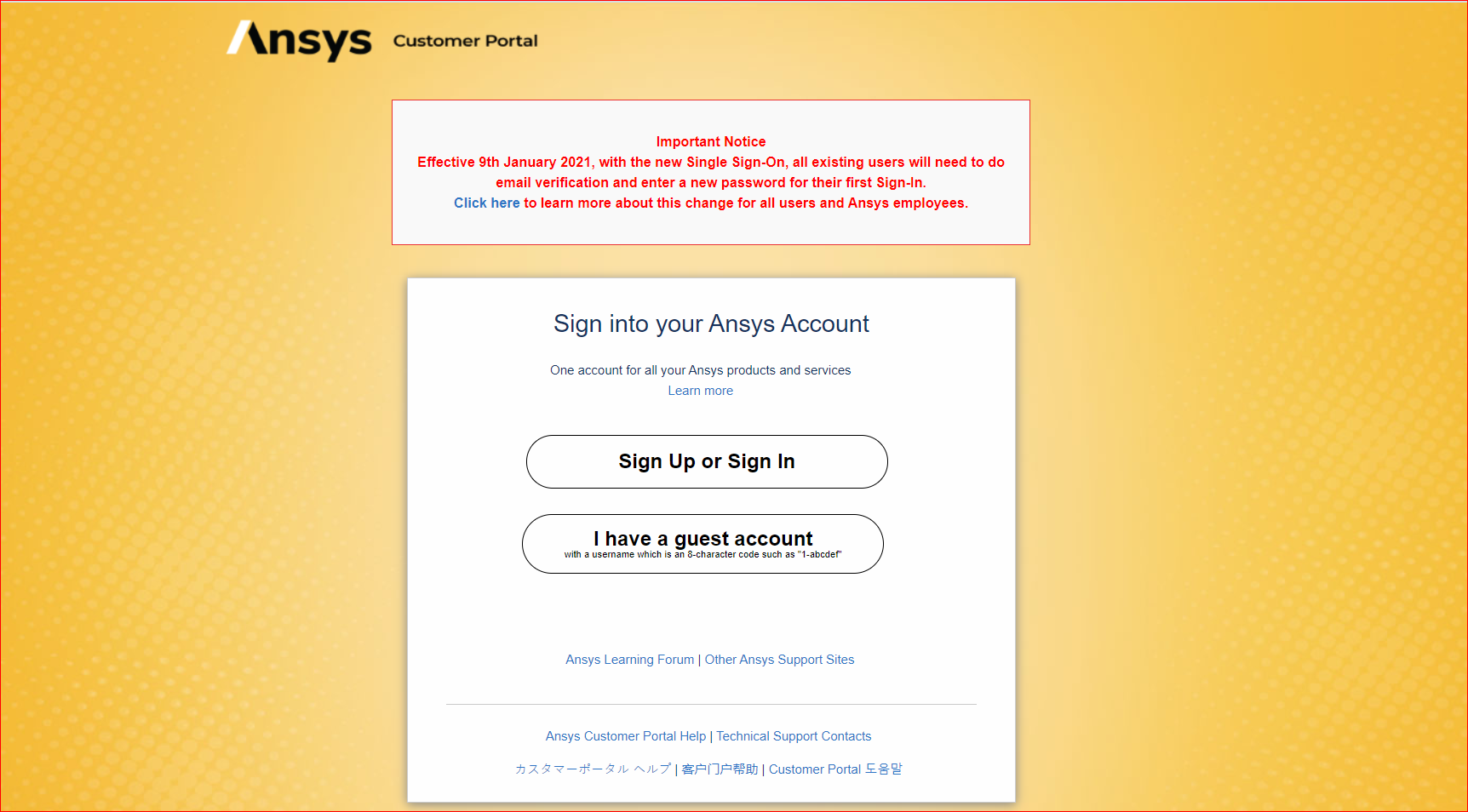

      But, I am not able to sign-in at the Ansys Customer Portal.

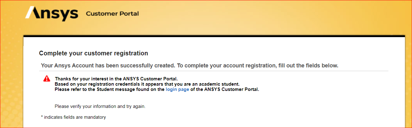

      Although, I have created an account at the Ansys Customer Portal using my institute email ID, and the message also shows that I have successfully created an Ansys account. Please find below the screenshot of the same login-page.
      As per the instructions, I have submitted all the relevant details as asked in the same page.
      But, as per the above message, I need to refer to the "Student Message" found on the" login page" of Ansys Customer Portal. I did not find any such message. Please find below the screenshot of the same.
      Every time, I Sign-in at the Ansys Customer Portal, I received the same message as shown above. I am stuck in this loop.

      Dear Sir Thank you for all your help.
      Now I have managed to install optiSlang and the Workbench, as per your instructions.
