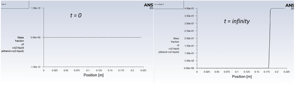

Result.
On the LHS mass fraction of co2 liquid is zero before starting the simulation at t=0. RHS, mass fraction of liquid co2 after running the transient simulation and allowing it to reach a steady state solution. The result make sense. Yes, at steady state the mass fraction show be 0.4 based on how i set it up.Â

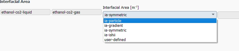

I now understand why I was not getting same result as fluent from my hand calculation. On the interfacial Area panel I chose ia-particle for the simulation, but I was using the formula for ia-gradient in the manual - which is NV_MAG(C_VOF_G(c,ppt)) - for my hand calculation. I think that's the reason my result were off because both formulation give different values.
I have some follow-up questions.

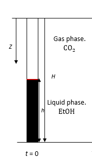

Consider the image below as my domain. gas phase @ the top & liquid phase @ bottom. Segregated flow. The liquid co2 from dissolution & ethanol are miscible.
Which formulation for the interfacial area is most suitable for my problem? I was using ia-particle before, but after reading the manual it seems to me that ia-symmetric is ideal for my case. Please what do you think?

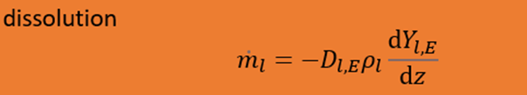

If i write a UDF for interphase mass transfer based on the above equation, should I write a UDF for interphase area and multiply it to this equation to get volumetric mass transfer rate? Or will fluent automatic do that if for me I chose one of the options for interfacial area concentration. ?
Thank you.
Regards Abolorunking
March 2, 2022 at 10:00 amAmine Ben Hadj Ali
Ansys Employee1/If the flow morphologies are assumed to be "continuous" either symmetric or gradient or user defined are the way to go.
2/If you want to write an UDF for mass transfer it should return the mass flow per unit volume and not the mass flux (per unit area). So your UDF should return the mass flux * Interfacial area as single expression. The choice of interfacial area you do in Fluent won't be used if you want to use your own mass transfer rate UDF (but you can access the interfacial area calculated by Fluent if you want to use it).

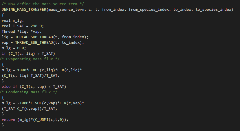

1/Could you please give some example where the interfacial area calculated by Fluent is accessed? I have written the UDF for the mass flux and to make it a mass source in the continuity equation I need to multiply that with the interfacial area per unit cell volume.
2/We access the flow variables like temperature calculated in Fluent as C_T(cell, thread). Similarly, can I directly access the gradient of volume fraction in my UDF using its macro, such as C_VOF_G(cell, thread)?

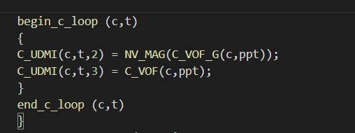

You can access the interfacial area per unit volume using C_VOF_G(c,t) as you rightly said. Be careful as C_VOF_G(cell, thread) returns a vector. So use NV_MAG to convert it to scalar.
Here is a snippet of my code. I stored the gradient in a UDMI and i defined it in adjust function.
Let me know if it helps.
Regards

Edit: Could you pls provide me few more pre/post lines of this code, actually I am not able to connect it in my code.

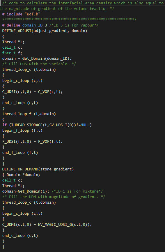

SubscriberHi, Thanks for your advice, I am able to calculate the gradient of volume fraction at each cell. The UDF is attached herewith:
/*Written and Compiled by Surendra Singh Rathore*/
/* code to calculate the interfacial area density which is also equal to
the magnitude of gradient of the volume fraction */
# include "udf.h"
# define domain_ID 3 /*ID=3 is for vapour*/
DEFINE_ADJUST(adjust_gradient, domain)
Thread *t;
cell_t c;
face_t f;
domain = Get_Domain(domain_ID);
/* Fill UDS with the variable. */
thread_loop_c (t,domain)
begin_c_loop (c,t)
C_UDSI(c,t,0) = C_VOF(c,t);
end_c_loop (c,t)
thread_loop_f (t,domain)
if (THREAD_STORAGE(t,SV_UDS_I(0))!=NULL)
begin_f_loop (f,t)
F_UDSI(f,t,0) = F_VOF(f,t);
end_f_loop (f,t)
DEFINE_ON_DEMAND(store_gradient)
{ Domain *domain;
cell_t c;
Thread *t;
domain=Get_Domain(1); /*ID=1 is for mixture*/
/* Fill the UDM with magnitude of gradient. */
begin_c_loop (c,t)
C_UDMI(c,t,0) = NV_MAG(C_UDSI_G(c,t,0));
end_c_loop (c,t)

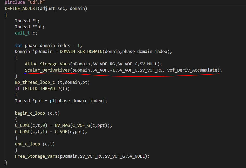

Ansys EmployeeI did not look thoroughly into the UDFs but both methods are okay. The official method provides you directly with the gradient of VOF. Moreover in newer version with VOF model one can access the interfacial area.
April 5, 2022 at 5:33 pmAmine Ben Hadj Ali
Ansys EmployeeOfficial method is documented in the Customization manual
April 5, 2022 at 5:35 pmAmine Ben Hadj Ali
Ansys EmployeeJust think about parallelization when writing UDFS

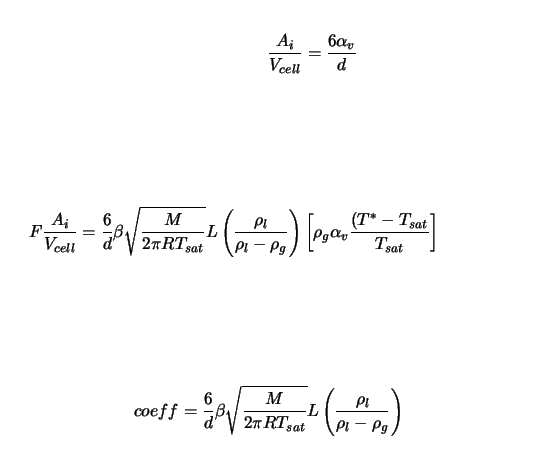

I have just one question to conclude the discussion, which formula of interfacial area density the FLUENT uses in the VOF based Lee's model of evaporation/condensation? I believe the mass source term (kg/(m^3).sec) in the continuity equation is created using mass flux (kg/(m^2).sec) and the interfacial area per unit cell volume (m^-1). In the FLUENT user manual, it is given only for the Mixture and Eulerian models and that is simply 6*phase volume/diameter, which is not true for the VOF model.

I believe you are accessing your interfacial area concentration (C_VOF_G) using fluent macro? If that is case, then I wouldn't worry about the formula for computing the IAC in the VOF method. Just multiply the VOF gradient magnitude obtained from (C_VOF_G) to your Schrage equation and you should be in good shape. You should be worry about the formula if you wanna write your own UDF for the IAC, it doesn't seem to be the case here.
If you have to write a UDF for your case (which I am assuming is a free surface flow), then see 's comment : "If the flow morphologies are assumed to be "continuous" either symmetric or gradient or user defined are the way to go" Check the user manual for the formula used for symmetric or ia-gradient formulation.

SubscriberI am now left with two choices, either using the macro of volume fraction gradient directly , or storing the volume fraction gradient as a UDS and storing further it to UDM and using it in my code to calculate mass source. The second choice which now I am trying although running fine but needs to execute on demand to transfer the UDS to UDM...multiple times during calculations. Please rectify this issue.
This is the second part of the code, please consider in continuation with trailing comment of mine...
