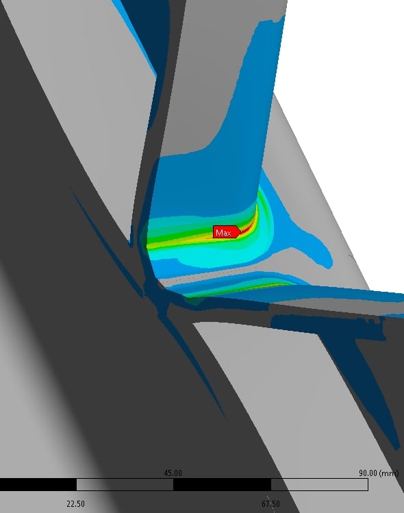

SubscriberWhat is the wall thickness? What displacement are you measuring?
I suggest the sphere of influence include the fillet around both tubes instead of just the center portion.

peteroznewman

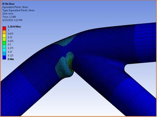

SubscriberI suggest you forget about the Sphere of Influence and just use the Mesh sizing control that is applied to the two tubes and the fillet. You can try size 10, 6.6, 4.4, 3.0, 2.0, 1.3 mm and plot that data. What would be interesting is to see the effect on the results at a fixed element size, say 3 mm, of changing the Formulation of the contact. MPC is probably the best.
I'm concerned that you have bonded contact in the region of high plasticity. I refer you back to the post that I made before that I don't like contact used in regions of high plasticity. This image represents an alternative way to make the connection. The bonded contact is far from the region of high plasticity which is occurring in a contiguous solid.

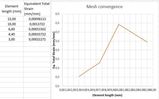

mekafime
SubscriberI added it in the previous answer.

mekafime
SubscriberHi Peter,
Could you open the model or I attach it wrong?

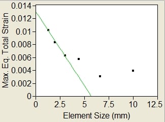

I see you measured Equivalent Total Strain at a Node. The intention of the convergence check is to plot the maximum global value, not one specific node. I am running your model across the element sizes to get new data to plot. This is automated using Parameter Set.
Is this data evidence of convergence to a zero element size result of Max. Eq. Total Strain = 0.013 or would the next data point at 0.89 mm element size be much greater than that? UPDATE: the result for element size 0.89 mm is 0.013265.

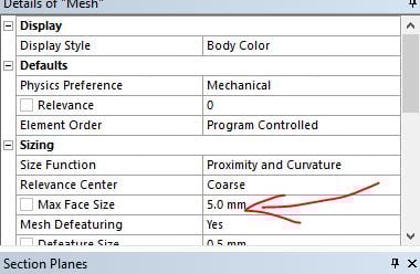

mekafime
SubscriberI tried to parameterize the unión but the same thing happens to me when I use 2 mm of size of element the computer freezes, What other option do I have?

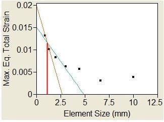

peteroznewman
SubscriberI was going from the 3, 2, 1.3333, 0.8888, 0.5925 progression and rounding off. I was tempted to run the last value to see where it came out. I switched to Sphere of Influence to keep the mesh size within the ability to solve In-core for the 0.89 mm size.
Suppose I did run the 0.59 mm size and it turned out to be on the green line pointing toward a Max. Eq. Total Stain of 0.02. That means that if you ran the model with the 1.3 mm element size, the result would show a Max. Eq. Total Strain of 0.01 while the true solution was 0.02. You could say that is a 100% error, but the better way to think of it is to compare the value with a critical value such as the elongation at break.
If your model was for a brittle material that has an elongation at break of 0.015, then the difference between a result of 0.01 and 0.02 is the difference between predicting success and predicting failure to support the load. In that case it would be important to use small elements.
If your model was for a ductile material that has an elongation at break of 0.5, then the difference between 0.01 and 0.02 is insignificant. In that case you could use larger elements.
