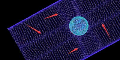

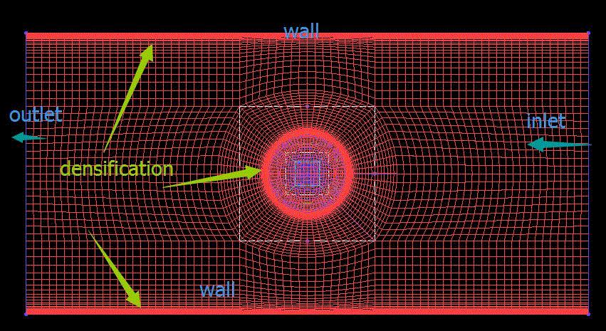

How does this model perform grid encryption?
    • h395523899
      This model is mainly used in fluent.
      Simulated liquid-liquid two-phase displacement flow.
      Size 10m*20m*10mm thin plate channel. Each side of 10m*20m has a hemispherical cavity.
      Hemispherical cavity diameter 3m
      One liquid enters from the 10m*10mm face and exits the other.
      1. Does the entrance and exit need to be refined? (No refinement at 20 meters)
      2. 10 meters, 10 mm edges need to be refined. Should y + be considered? What is the distance from the first node to the 20m edge of the 10m edge?
      3. Is mesh refinement necessary at the contact between the thin plate and the hemispherical cavity?
      4. If you need refinement in 3, there will be four tangents at the round mouth of the hemispherical cavity. These four tangential expansions will also bring refined gridlines. Will this lead to errors?
      I uploaded my model, thank you?

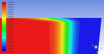

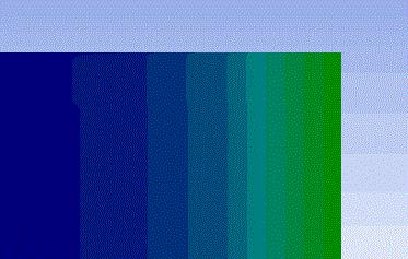

      1. I changed a grid method, such as graph. It should be better than before.
      2. I want to know the extent of mesh refinement.
      About grid thinning. The reason is that the simulation process appears at the boundary as shown in the diagram.
      The simulated water replaces oil. But at the boundary, water is faster than oil. This is not in conformity with the facts.
      I think it is related to the thinning of the wall mesh, so I want to refine the wall mesh. But I don't know about the extent to which it is refined. Maybe the thickness of 10mm is not suitable for y+ calculation..
      Volume fraction cloud image, blue is water

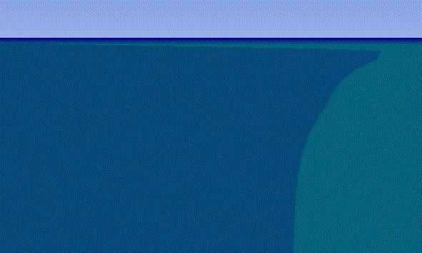

      3. mesh refinement is carried out in the new grid. But when the boundary is enlarged, it still appears as picture.
      Water speed cloud
      4. I mainly simulate the change of the volume fraction of the oil in the hemisphere. Is there any need to refine the part of the thin plate and hemispherical contact (including the inner hemisphere)?
