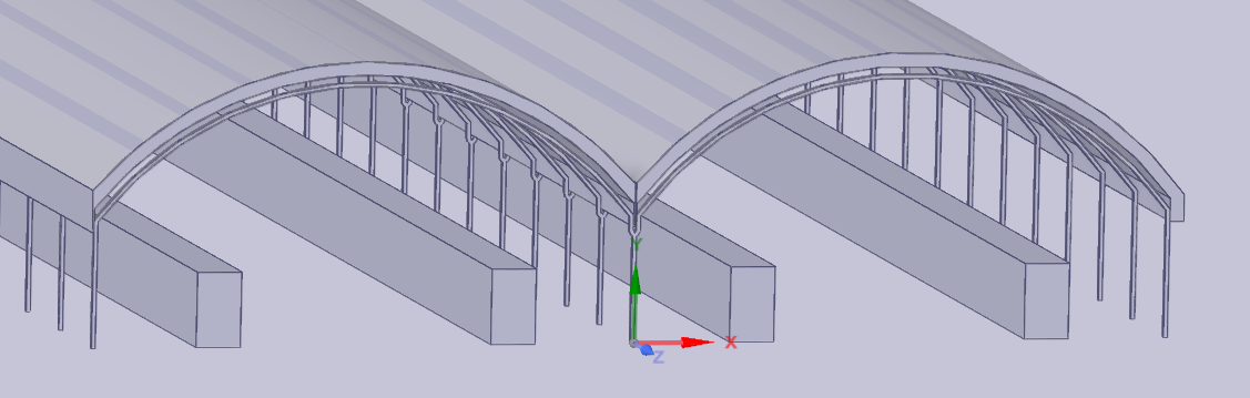

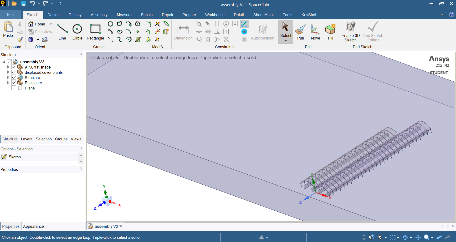

SubscriberI'm too new to this to be able to properly explain the problem, but the basic scenario is that I'm trying to model wind flow around/through an open greenhouse (really more of a very large gazebo with plants inside, if I'm being honest). I made the model in inventor because it was the modelling software I knew how to use, imported it into workbench as a step file, build an enclosure around it as pictured (the huge size along the sides is because I'm trying to model variable wind flow direction, and I calculated that based on the angle, that side distance would mean that wind flow could travel in a straight line from the corner of the enclosure to several meters past the corner of the greenhouse).

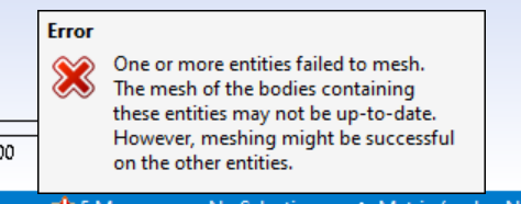

EDIT: New error message in the mesh editor:
Just getting the basic "Update failed for the Mesh component in Mesh.Error updating cell Mesh in system Mesh. View the messages in the Meshing editor for more details" in workbench

Forum ModeratorTo confirm, you have a solid body 0.2mm thick? How big are the struts? What's the overall domain scale? Remember if you have a body 0.2mm thick you must has one cell across the gap, so the overall cell count may be rather high.
November 25, 2021 at 12:13 pmLarz_Johnston
Subscriberah, now that information contains the sort of basic thing I think I may have been missing (as I said in the original post, I'm very new to this).
Yes, the sheet is 0.2 mm thick. Meanwhile, the struts are 120mm filled-in square posts and repeat down a length of more than 50 meters (they were originally pipes, but filled in squares seemed faster to model based on some tutorials. but the size of the domain is probably the big one: because of how I'm approaching this (with variable wind direction) I've made the enclosure very big, so that a straight line from the corner on the steepest angle will still completely miss the greenhouse. That size may be affecting the model itself. It's also possible that it's a problem with the import method: I'm building the model (sans enclosure) in inventor, with the cover constrained to exactly match the arc of the struts, then exporting as a STEP file and importing. I've noticed that the arc of both parts is much more jagged than it should be (more like a polygon than an arc). when it is too close it overlaps and causes issues, or creates an area too small for simulation resolution if it's moved just enough to stop intersection.

Forum ModeratorOK. This makes more sense. In CFD we model the fluid side, and on occasion the solid parts if they heat up. To do this we must resolve the features. With the scale you're working at it's very likely that CAD tolerances are causing the two side of the "roof" to overlap: the faceting isn't refined sufficiently.
Taking a big step back. What do you want to learn from the model? Assuming it's just flow, with some heat transfer we can throw away the roof solid: it's a thin surface. We can also lose the posts as they don't really do much to the flow. Have a look at the coupled wall option in Fluent (Boundary conditions chapter, under wall I think).
