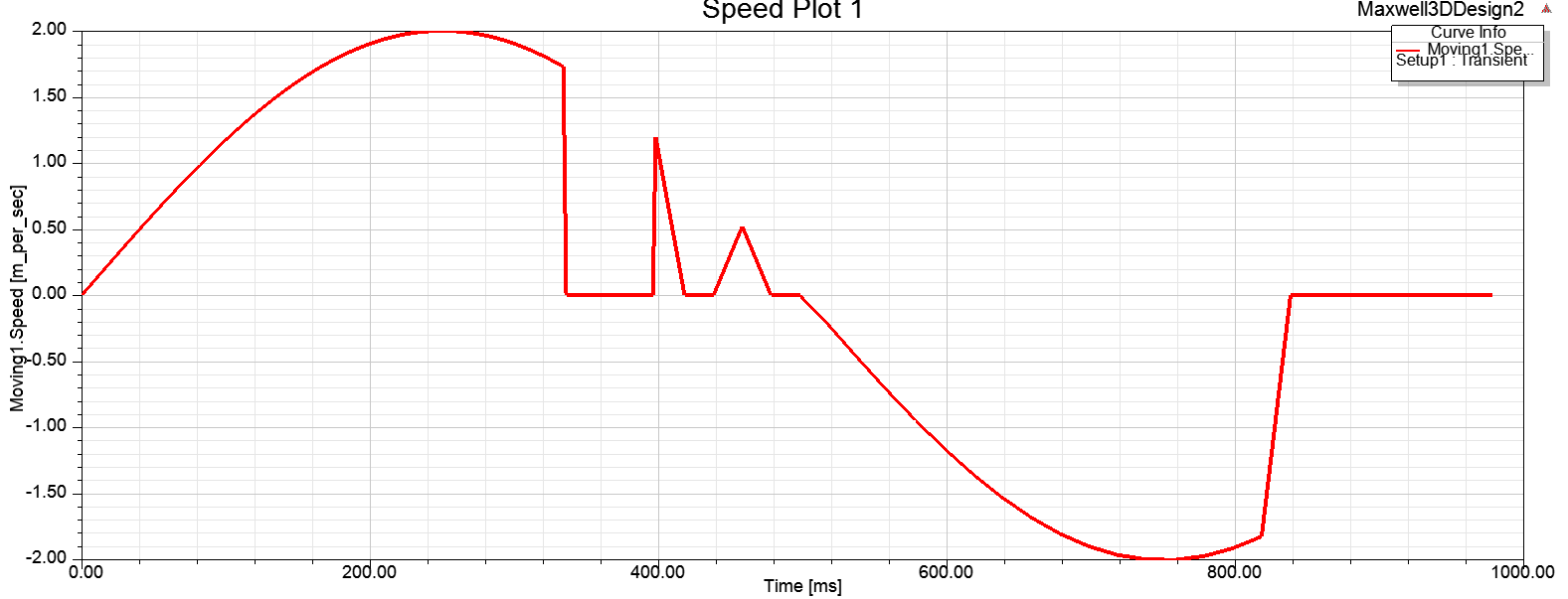

      How do I find out internal resistance of coil in Ansys Mxwell transient 3d solver? I designed a generator and in excitation I added coil and external circuit . I want to know the inductance and resistance of coil. So that i can add same value of resistance as load resistance to get maximum power output based on Maximum power transfer theorem.nAlso, in Motion setup when i give sinusoidal input velocity as 2*sin(2*pi*time) then output should be sinusoidal voltage and current. But I am not getting sinusoidal. Please help.n
    • s3740222
      When i give velocity as 2*sin(2*pi*time) I get this output. Why not sinusoidal ?

      Shape of output voltage is dependent on rotor construction, placement of magnets and on the winding distribution. If you have a proper 3 phase distributed winding and magnet arrangement (in case of PM generator) or proper pole shape (in case of wound field generator) then you can get a sinusoidal voltage.
      You should run the generator at certain constant speed to really check if your output voltage is sinusoidal in stable condition.
      By defining a sin function as speed you are actually introducing fluctuation in speed at different time intervals and it will impact the magnitude of your output voltage and this may eventually look like non uniform shape but will not give an idea of how your generated emf looks like.

      Navya i am making linear generator to work in ocean thats why i am trying to give sinusoidal input velocity to the translator.

      I am assuming you have permanent magnets on your slider.
      External circuit you are defining is on the armature with winding. So, I don't think you should add anything to this external circuit to get the sinusoidal induced voltage(output) as it may not reflect the practical case.
      As, a first check, can you assign a constant velocity to your slider and check if you are getting a constant and linear output voltage ?. Depending on this result you will understand how your slider moment is translating in to output voltage and whether it will really follow the velocity function. The reason I am asking you to do this is, as you know a linear generator is just a unrolled rotary generator and similar to rotary generator it should generate similar output voltage waveform depending on the construction.

      I tried running with constant speed and I am getting sinusoidal output but I need to get sinusoidal output with sinusoidal velocity based on my project requirement.
      I can understand that you cannot help me beyond certain point but this is related to ANSYS only. I think there is some problem with the software as when you give sinusoidal velocity the output should come out as sinusoidal according to the literature. But in Ansys this is not happening. I am getting triangular shaped output. In my case the magnets and coil both are on the moving part.

      Hi Pooja,
      The statement you are saying " you give sinusoidal velocity the output should come out as sinusoidal" is not correct. Your design/generator might not be same as the literature you are referring. Please cross check with the reference design.
      This is because, as you saw, you are getting a sinusoidal output from constant velocity. What do you infer from this?
      This is happening because you have a spatially distributed winding and a constant magnetic flux is cutting the conductors.
      This shows that tool is working correctly and there is nothing wrong with the output you are getting.
      It will be inappropriate for me to comment why you are expecting a sinusoidal velocity function to generate a sinusoidal output with out knowing about your design.
      I didn't understand your statement "In my case the magnets and coil both are on the moving part"
      If possible upload some screen shots of your model with some annotations on it for me to understand your model and setup. With out which, at this stage, there is high chance that I will be making wrong assumptions about your design.
      Also where are you using this L & R in transient simulation? Provide screen shots for everything from now on to avoid misinterpretation.
