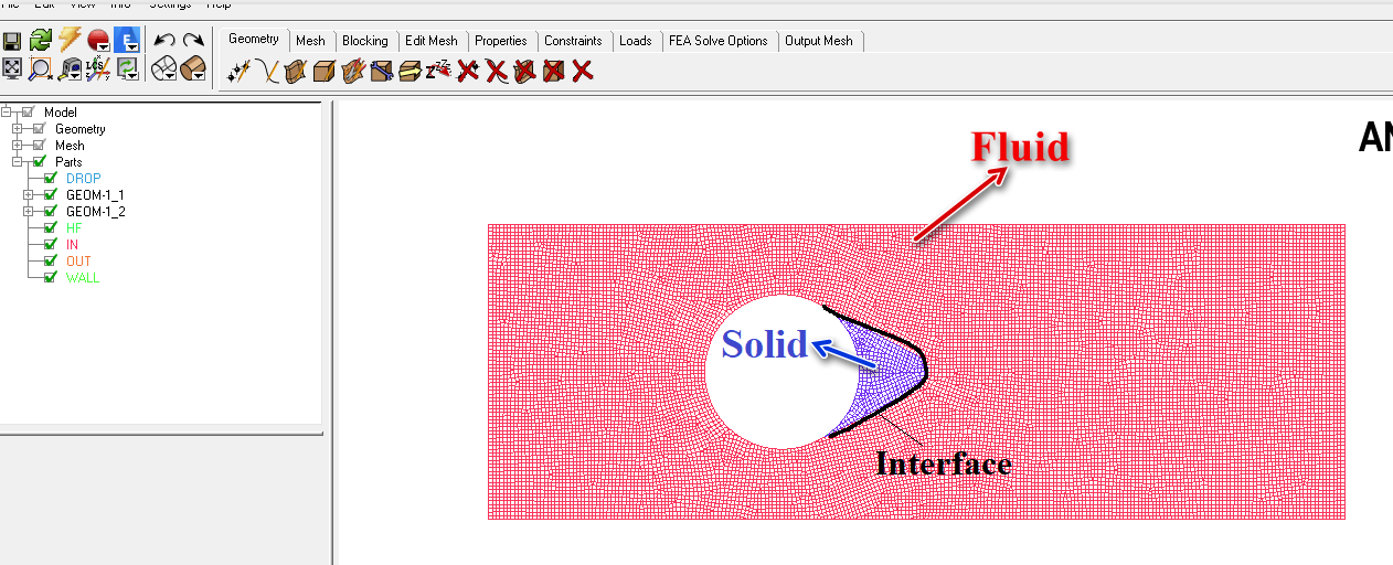

May 27, 2021 at 2:00 pm
RawadSy
SubscriberMay 28, 2021 at 5:00 pmSurya Deb
Ansys EmployeeHello,
To have an interface in Fluent, you have to have non-conformal mesh on both sides of it. You can start with a conformal mesh as well but will then need to split the zone.
Please see the link for more information: https://ansyshelp.ansys.com/account/secured?returnurl=/Views/Secured/corp/v211/en/flu_ug/flu_ug_Manual_Create_Edit_Mesh_Interfaces.html?q=interface
Regards SD
Viewing 1 reply thread- The topic ‘How can we define the interface for a two-dimensional problem?’ is closed to new replies.
