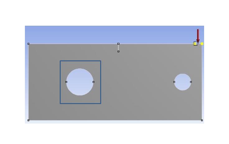

SubscriberI am using SMART crack (Fatigue crack) in Ansys 19.2. So when I generate result for normal stress or von mises it focus on the crack front. Is it possible to obtain stress concentration value specifically at the hole region? Thanks in advance. I am sorry if my understanding is wrong, I'm just confused right now.

SubscriberBefore this i alrdy tried to select surface element around the circle, but error popped up when i want to evaluate the result. Something on mesh changing error and the scope. i once saw a video on youtube on that. As you said, he select specific surface to evaluate and got the result. When i tried myself, error keep popping up.

SubscriberNo sure what you mean with surface element, but the idea is to select that face and look on the stresses only there (rather than entire body).
If you upload your model than we could have a look - also show what you mean with "selecting surface element" - do you mean a finite element (say plane stress elements) or a face?
