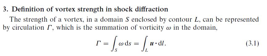

SubscriberHow can i measure circulation strength for the simulations which i have done using Euler calculations in fluent?

Forum ModeratorCan you explain what you mean by circulation strength? We can plot velocity vectors & contours and report forces but I've not come across "circulation strength" before.Â

Forum ModeratorYou can get tangential velocity if you define the fluid zone centre of rotation (typically used in cyclones etc), you then need to create a line & use the surface integrals or a custom field function.Â
If it's a shed vortex then you need to ID the centre: then use a custom function, vorticity magnitude or (I think) there's a feature in CFD Post.Â
