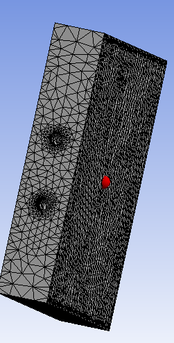

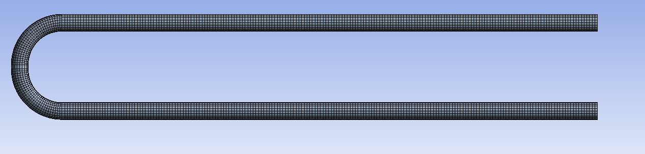

Subscriberthe system is a single tube heat exchanger where there is a fluid flow in the tube and another fluid domain in the other part heat exchanger. I want to do their mesh separately and then unite then for proceeding the setup in fluent or CFX. thanks

SubscriberbECAUSE I WANT TO HAVE A STRUCTRED MESH FOR BOTH THE DOMAINS.

Forum ModeratorGiven the shape of the block you can't. Why do you think you need a structured mesh?
Edit, you probably can get a block structured mesh but it'll not be an easy task and will almost certainly give you some very skew elements.

Subscriberit is just for faster results and minimum number of elements than tetra. for the block i can do it tetra (i just made a mistake sayinf for both domains)but the flow i want it to be hexa structred mesh
July 2, 2021 at 4:43 pmmounaraha
Subscriberi wanted to do all the system in the same session in ansys messhing but i don't know how to choose different size element for the tube channel and for the block. that is why i wa thinking of separating the mesh. Need help for that

Forum ModeratorIf you want to set sizes for each block (or part) you need local sizing. Right click on the volume and use the insert option. From your comment I assume you're changing the sizing at the global level which alters the whole mesh.
If you want (for example) swept mesh in one part and tets elsewhere for a conformal mesh I'd mesh the tet volume first (read up on selective meshing) and then the swept section. That will (in theory, and assuming you don't set anything else up) sweep a tri mesh giving prisms. Going the other way gives a pyramid cap which can lead to poor quality cells if you're not careful with the sizing.
