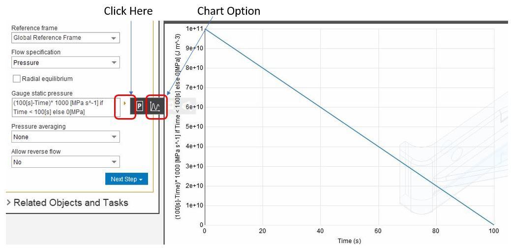

It is possible to write pressure as an expression of time in Discovery AIM but this is not possible with Discovery Live. I believe your problem is concerned with AIM.
You just have to start writing an expression under the pressure tab and as you write “Time”, program recognizes this as standard analysis time:
In the example below, I have written an expression such that pressure drops down to 0MPa at T = 100 seconds and stays at zero even if the analysis proceeds further. Please note the use of conditional statement and rectangular brackets are used to specify units in order to ensure dimensional accuracy.

Subscriberi wrote as you suggested ; it seems to be OK ; indeed there is a value disaplyed corresponding at the initial time.
Is there any way to plot the function i defined?-
September 6, 2018 at 6:06 am
September 6, 2018 at 5:49 pm
alain.benchissou
SubscriberGaurav_ANSYS
Thansks for that
hi, are using version 19.1 or 19.2?
September 7, 2018 at 6:35 am
Gaurav Sharma
Ansys EmployeeThe snapshots I shared with you are from 19.1.
