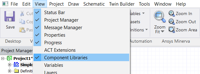

SubscriberThe website http://model.simplorer.com cannot be open. How can I find the device models of some manufacture when I use the simplorer? Such as some operational amplifier、IGBT、mosfet、optocoupler. It is a heavy workload if I set all the device myself. Who can tell me? Thank you very much!

SubscriberHi pmunaga Thank you for your reply. I have another question. Whether can I find some specific device models , such as Op07, Opa544´╝îlike in the Pspice?

SubscriberHipmunaga Thank you for your reply. I have another question. Whethercan I find some specific device models , such as Op07, Opa544´╝îlike in the Pspice?

Forum ModeratorHi @Burgess You can import the PSpice models into Simplorer.
Tools>Project tools>Import twinbuilder models.
Then select the saved PSpice models to import.
Regards Navya
