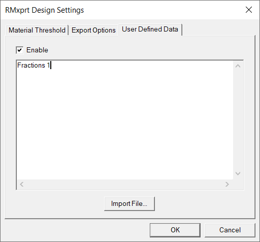

Forum Moderator.Hi @Minseok,
Are you creating this model from RMXprt?
If so, before you analyze the RMXprt model, do the following
RMXprt>design settings
on the popup window select user defined data and modify as below and click ok
Then create the maxwell model to get the full modelRegards,
Navya

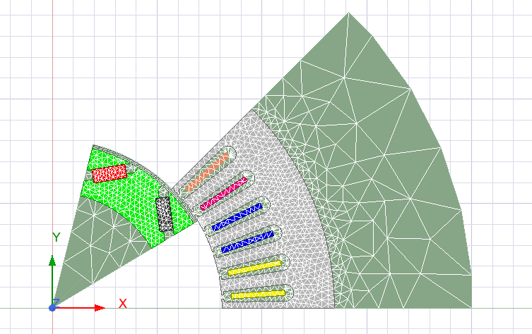

.February 23, 2021 at 4:30 amMinseok
SubscriberThank you for answering my question.
And sorry to confuse my question about unclear explanation.
First, that model is Maxwell 2D modeling and analyzed in the Maxwell 2D.
Second, for considering computing time, that model is split to 1/8 model size.
So, I want to view the result of 1/8 model to the full model, as just graphical expansion (Not full model analysis result)
In other words, I want that result duplicated just graphically when the magnitude of B or flux lines are displayed.
Thank your
Minseok
June 28, 2021 at 7:41 amkunaldugvekar
Subscriber.This requirement in the recent version is default.
You will be able to see the complete plot irrespective of the model solved.
