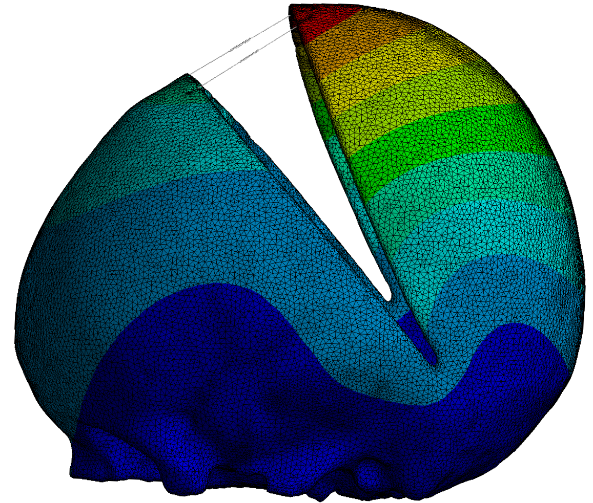

      Starting in Ansys, I wanted to export the matrix of nodes of my deformed geometry (shell of an opened skull) into Matlab in order to compute the volume of a convex hull and then send the result back to Ansys to use the volume value as a parameter.
      Is there a way to achieve that?
      Or is it possible to compute the volume of a convex hull directly in APDL?
      Many thanks in advance for your help!

      Volume hull is supposed to be an approximation because I didn't find a way to compute it in Ansys (my deformed geometry is opened)
      Right now I'm exporting the mesh for each design point of my DoE into matlab, calculate the volume and then import the results in a .csv file back in the DoE in a new project in Ansys to analyse the response surface.
      I don't know if I'm clear enough but do you think it would work?

      This is one of my models, I don't think I could fill that with fluid elements without considerably increasing the complexity and the computational time (already high). And how to define the boundary at the opening?

      Also, have you tried correlating the spring length with the volume change? It looks like the slot in the skull will be opening and closing about the corner (like a pivot). You can easily find out the cross section area (and its centroid) in a cad tool and then use the "Pappus Theorem for Volume of Revolution" to calculate volume it spans during deformation. You could parameterize the spring length, send it to excel calculate the volume and send this as an output parameter. This is obviously an approximation (so is the volume of hull) bit it will be easier to implement and automate for DOE study. You could compare it with the volume of hull obtained using MATLAB and check whether they are close or not.

      As for your second proposition, we thought about it too but unfortunately it would not work for the whole population as some models have a more complicated opening and also expand laterally.
