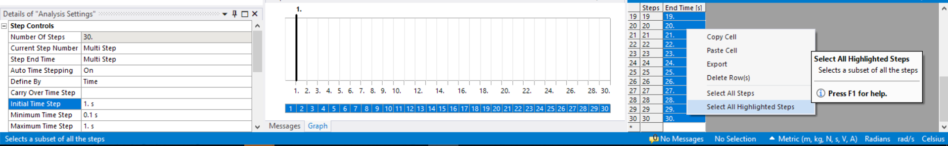

      I am trying to apply a tabular force on a structure, but it takes like forever to change these settings for every single time step
      Is there another way to apply it ?!

      If we have the same initial time step, and so on for all the steps defined, the we can select multiple steps on the steps/end time tabular data (just select all rows, right mouse button click and select all hihghl. steps, like shown in the image below). Once we have that we can fill them in and, that will be applied for all time steps.
      If you do not have the same time steps, for all steps, then it needs to be done one by one, like you do now probably.

      If you have the time history for the force, why don't you use that on a single time step? Why do you need 40 time steps?
