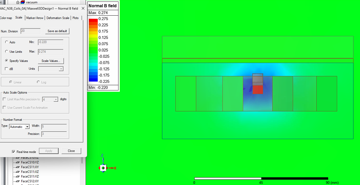

    • e.jankes
      I have probably similar question.
      I am simulating a system with magnets and two coils. I am able to create the Mag_B more or less anywhere I want.
      But, how can I get Normal B field (Bx) and Tangential B field (Bz) at for instance Global XZ or Global YZ? I have these data/results from the 2D FEMM software. But I would like to get something similar from 3D model in Ansys Electronic student.
      Thank you
      Erik
      • GLUO
        Please right click field overlay>>field calculator>>Quantity>>B>>Scal?>>ScalarX>>Add  to save the expression for Bx. Then it is listed in named expression for field overlay plot and field reports. If the solver is eddy current, you will need copy Bx to stack>>Complex to choose one of the value for the phasor.

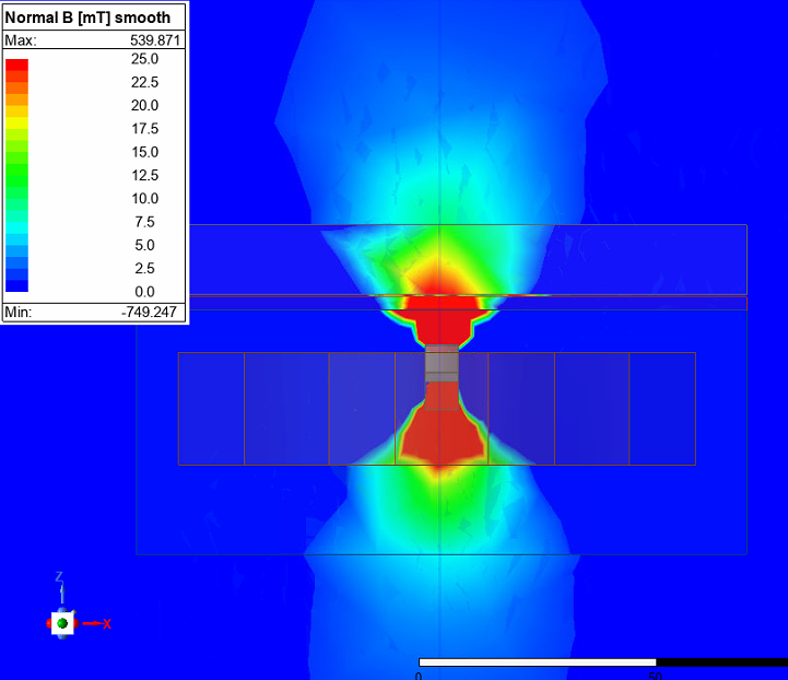

    • e.jankes
      thank you. it seems to work.
      One more question, How can I change units? I have probably T, but I want mT and I can not use option modify attributes its locked for any unit change.
    • e.jankes
      I probably found a solution. I add few more steps into your steps: Quantity>>B>>Scal?>>ScalarX>> General >> Smooth>> Input>> Number, Scalar 1000 >> General >> * >>Add
      Since, I can not change units, I write them manually as part of the name.
      Am I right with these changes?
      Smooth make smoother visualisation?
      Scalar 1000 make change from T to mT?
      • GLUO
        Am I right with these changes? Yes
        Smooth make smoother visualisation? Yes
        Scalar 1000 make change from T to mT? Yes
