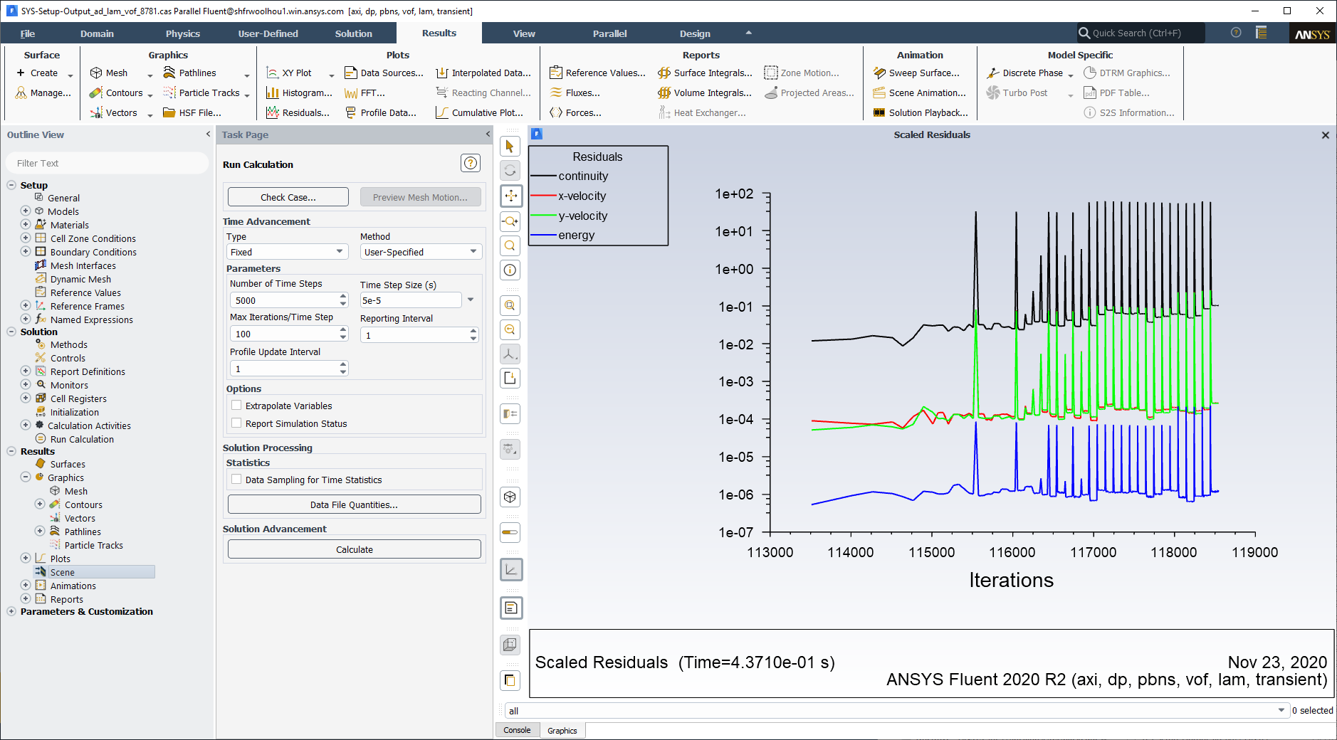

      That's a box with a hole in the side to let the liquid in. Geometry is easy, mesh isn't too difficult, learning the VOF and VOF to DPM model functions may take a bit more time. Making it work with 512k cells (Student limit) will also be difficult. There's a tutorial on the Ansys Learning Hub (or will be when it's finished) but you need a subscription to access that. n

      That's a hex mesh, and is probably displaying the mesh on a surface to highlight the dynamic adaption. The image looks to be using the objects and scene tools from the tree under Results. nI've (just about) highlighted the option. n

      You need to create a volume mesh. The video is displaying the volume mesh on a plane/isosurface/interior face to highlight the adaption. n
