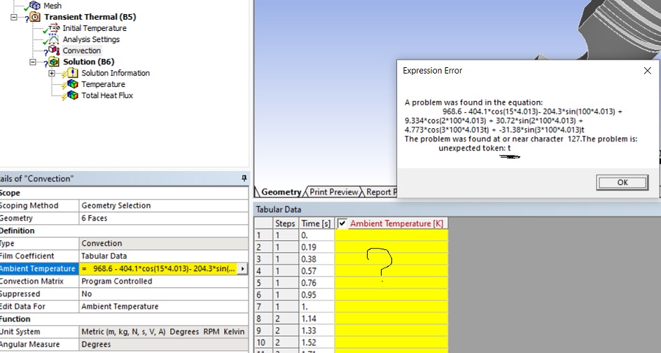

Subscriberhow add ambient temperature as a function variable with time? and how I can be defined this is time as variable in transits thermal Ansys ? Â

peteroznewman
SubscriberIf you want to multiply a number by t, then you have to put an asterisk in front of the t.
For example 4t is invalid syntax, while 4*t is valid syntax.
March 5, 2020 at 10:45 am
engmahmood
Subscriberthank you so much sir , i solved this problem

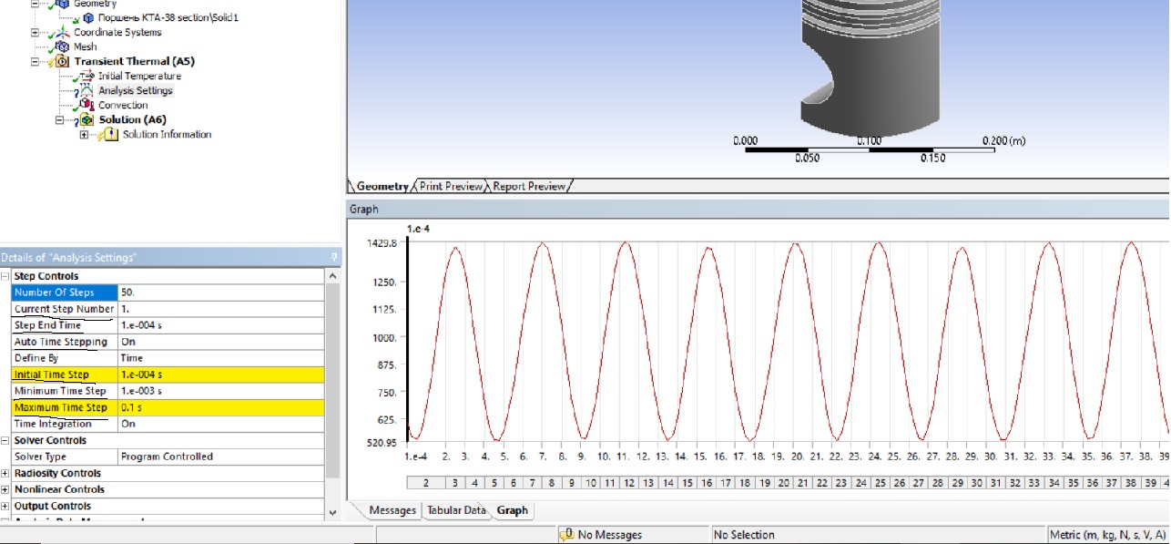

peteroznewman
SubscriberThe initial time step must be larger than the minimum time step.
Try using 1e-3 for Initial, 1e-4 for minimum and 0.1 s for maximum.
