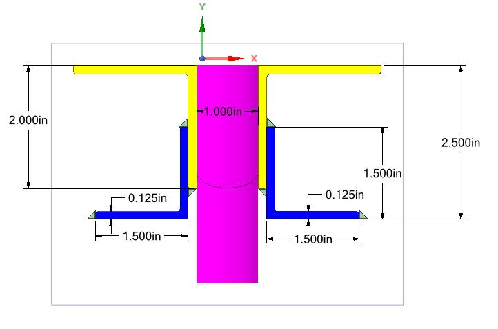

Horizontal Reaction with uplift vertical applied load
    • Sam Fares
      i have a 2310 pounds acting vertically upward at center of rod( pink). In the results , there is 801 pound in horizontal X-direction as shown below. How does a vertical uplift force produce a horizontal X-direction reaction?
      Sam
      I expect there is an equal and opposite force of 801 lbs on the weld on the left.
    • Sam Fares
      Yes there is an equal and opposite. But i am wondering what causes or how this horizontal force develop when the applied force is vertical.
      Thanks Peter!
      Sam
      When the angle brackets were bonded to the weld bead, which is fixed, there was no stress in the angle bracket.
      After the vertical load was applied, the angle brackets have rotated a significant amount, like 20 degrees, therefore the horizontal length has foreshortened by cosine(20 degrees) = 0.94, that creates tension in the horizontal leg of the angle bracket of 801 lbs.
