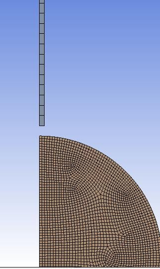

SubscriberI am trying to simulate a 2D contact problem with very high displacement BC's and getting an error that element has highly distorted. Because of that solution is not converging. I have tried with increasing the number of load step and sub steps but it is not helpful. Some elements are flipping because of very high displacement, so how can i solve this highly distorted element error.Â
Any advice or help would be appreciable.Â

SubscriberIt looks like you need a much finer mesh on the pin doing the indenting and the object being indented.

Thanks for your suggestion, but i have tried with local refined mesh at the contact area and that was also showing distorted element error. Only in case when i am using very coarse mesh throughout the geometry then only i am getting a converge solution. But that mesh size is very coarse, that why it is not distorted. so how can i get converge solution with fine mesh.

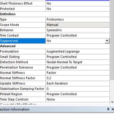

i have tried the things that is mentioned in the link like reduce normal stiffness upto 0.2Â and changed Detection method for contact elements from program control to Nodal-Normal to Target. Bur still solution is not converging because of elements are still distorted.

I can't see the tip of your poker. It cannot have a square corner (except for on the symmetry plane or axis, which is not really a corner), you must put a radius on the corner of the poker. There must be at least four elements around that radius on both the poker and the ball. That is what I am talking about small elements. If you have a square corner on the poker, that is the reason why you are getting distorted elements.

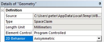

yeah, it is 2D model Axisymmetric and i have putted 1 micron thickness (thickness is mandatory even in 2D model) with 120 micron diameter of semi circle and i have already turned on Large Displacement in the Analysis setting.

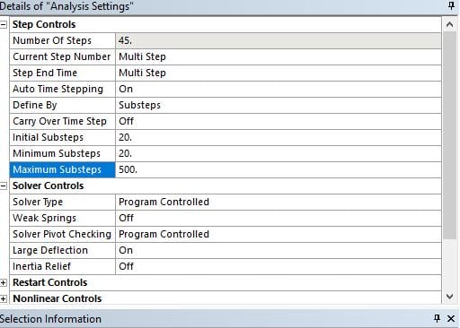

I have putted 45 steps with max 500 subteps in each steps for 45 micron displacement. And i using Linear isotropic material with 100 KPa Young's modulus and 0.49 Poisson's ratio. And where in will get Reduced integration Elements.

"thickness is mandatory even in 2D model"Â This is not true, you have made a mistake somewhere.Â
Create a new Static Structural system in Workbench, RMB on the Geometry cell and select Properties. In the Properties window on the right side of Workbench, there is Analysis Type that defaults to 3D. Change that to 2D. NOTE: If you already built a model, you cannot go back and change 3D to 2D after the geometry was attached to the Model. You must start over.
Now start the Geometry Editor. Create the surfaces in the XY plane with the axis of rotation along the Y axis. These are surfaces, not 3D solids.
Double click on Model to start Mechanical. Click on Geometry. In the Details window, you can set the 2D Behavior to Axisymmetric. No thickness is required.Â
Please reply with confirmation that you have done all these steps.
On the substeps, you didn't say you set the minimum substeps. I don't care about the max substeps. And 45 substeps may not be enough, you might need 100 or more.
Please reply with a zoomed in view of the elements around the tip of the rod.
