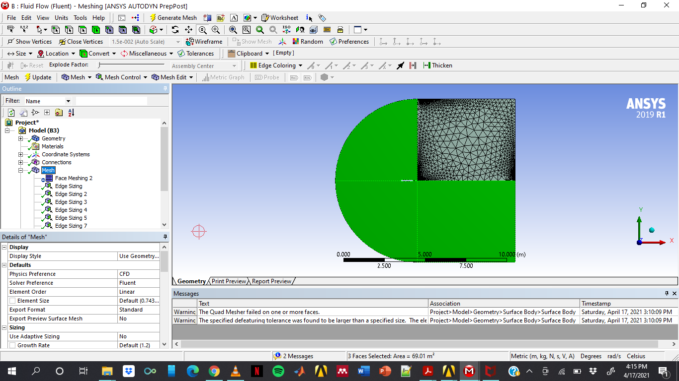

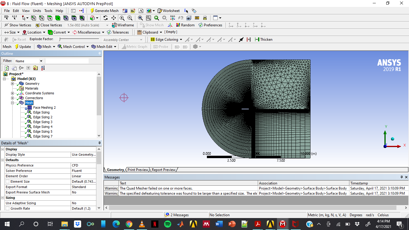

SubscriberHi. I am facing an error while meshing my geometry. The geometry works perfectly fine and I have created four quadrants through the 'projection' tool in DesignModeler which works fine as well. However, when I check 'show mappable faces' in mesh, only three quadrants appear instead of four. Hence I get structured mesh in 3 quadrants and a highly unstructured and unstable mesh in the 4th one. I have attached pictures of the error. Actively looking for the solution, thanks.n
n
April 19, 2021 at 5:14 amKeyur Kanade
Ansys Employeenplease create a new post. this is different issue for mapable faces. nViewing 3 reply threads- The topic ‘Hie . Can anyone kindly assist with the preprocessing meshing errors: Failed and Obsolete Errors.’ is closed to new replies.
