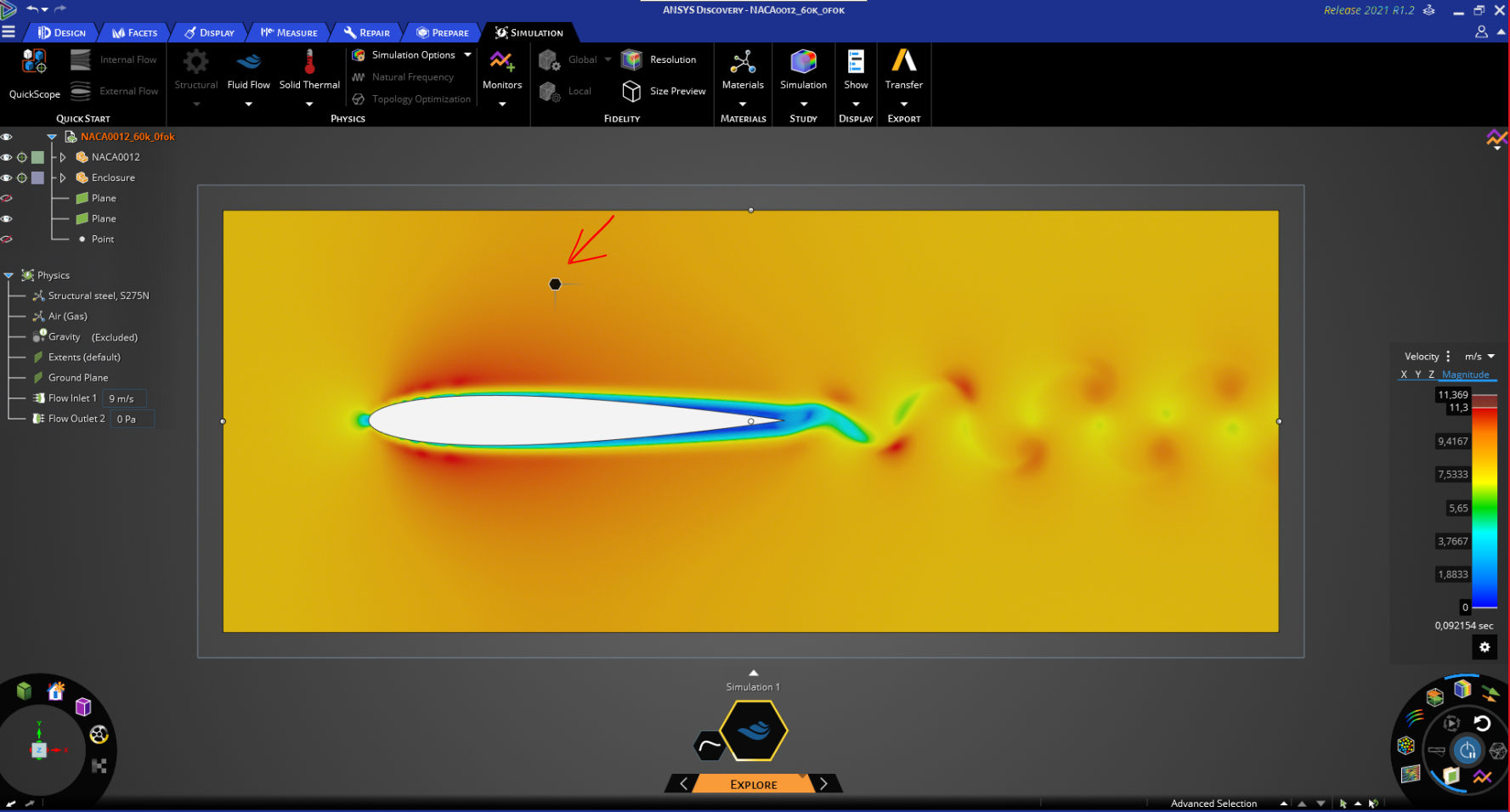

      Is it possible to hide some elements of the HUD (?) in Discovery 2021R1? For example, the small bit covering a part of the fluid simulation, please refer to the attached image.
      I'm creating a video animation using screen capture (as there isn't a built-in animation tool), and simply hiding it would be much easier than cloning it out in post. Repositioning (moving) the marked HUD element would also do the trick, but I wasn't able to do that either.

      Hello Bálint Papp
      If you press the Ctrl key, it will hide the black colored hex representing HUD. It will remain hidden as long as you keep the Ctrl key pressed. The 2 lines associated with this hex will still be visible though, but that should be fine I guess.
      • papp
        Naresh Patre I see what you mean, it improves the image a bit. Thanks for the answer!
        Am I correct to assume that it cannot be fully hidden, right?
    • Naresh Patre
      Bálint Papp
      Yeah, it cannot be fully hidden as of now.
