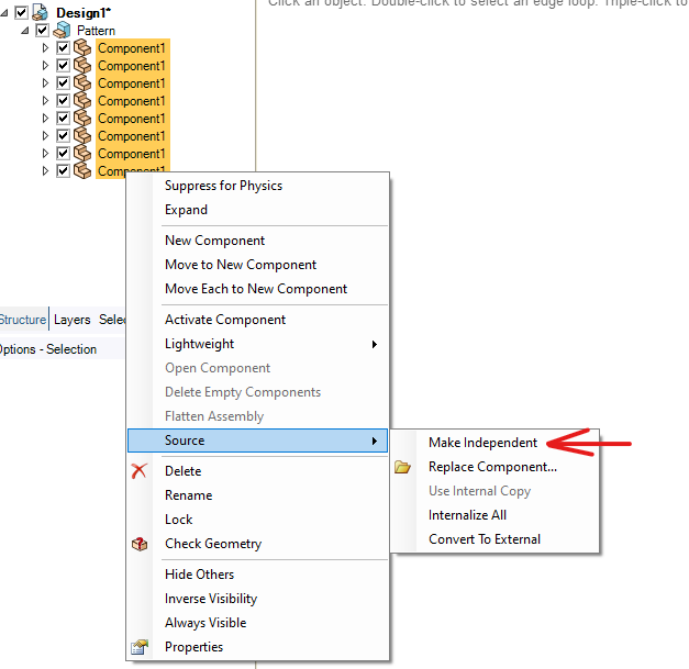

      Hi
      1) I cannot figure out why some parts are moving together even there are not linked together with any constrants or they are not merged.....

    • Charudatta Bandgar
      Hello SandorToaso
      This ideally shouldn't happen. Can you please either share the model with me, or the video recording of such instance?
      2) If I extrude pattern liked part than all parts are extrded and not only the given one. Where can I find this odd behaviour swithces for the above 2 cases?
      Is this happening when you have defined a pattern of the bodies? In that case there will be a connection shared between these geometries and this is intended behavior. If you want to delete the connection between them, you can right click on all the patterned components and go to source>make independent
      • SandorToaso
        Charudatta Bandgar Hi Thank you,
        1) I try to create movie but not sure how in WIn10... will come back with it
        2) it is not a pattern but the assembly is copy+ pasted from an another spaceclaim file which is/was opened in a separate tab.
        After copy+paste I have not found a way to disable this dependencies. I guess the first strange behavior is also happening on a copy pasted objects ONLY.
