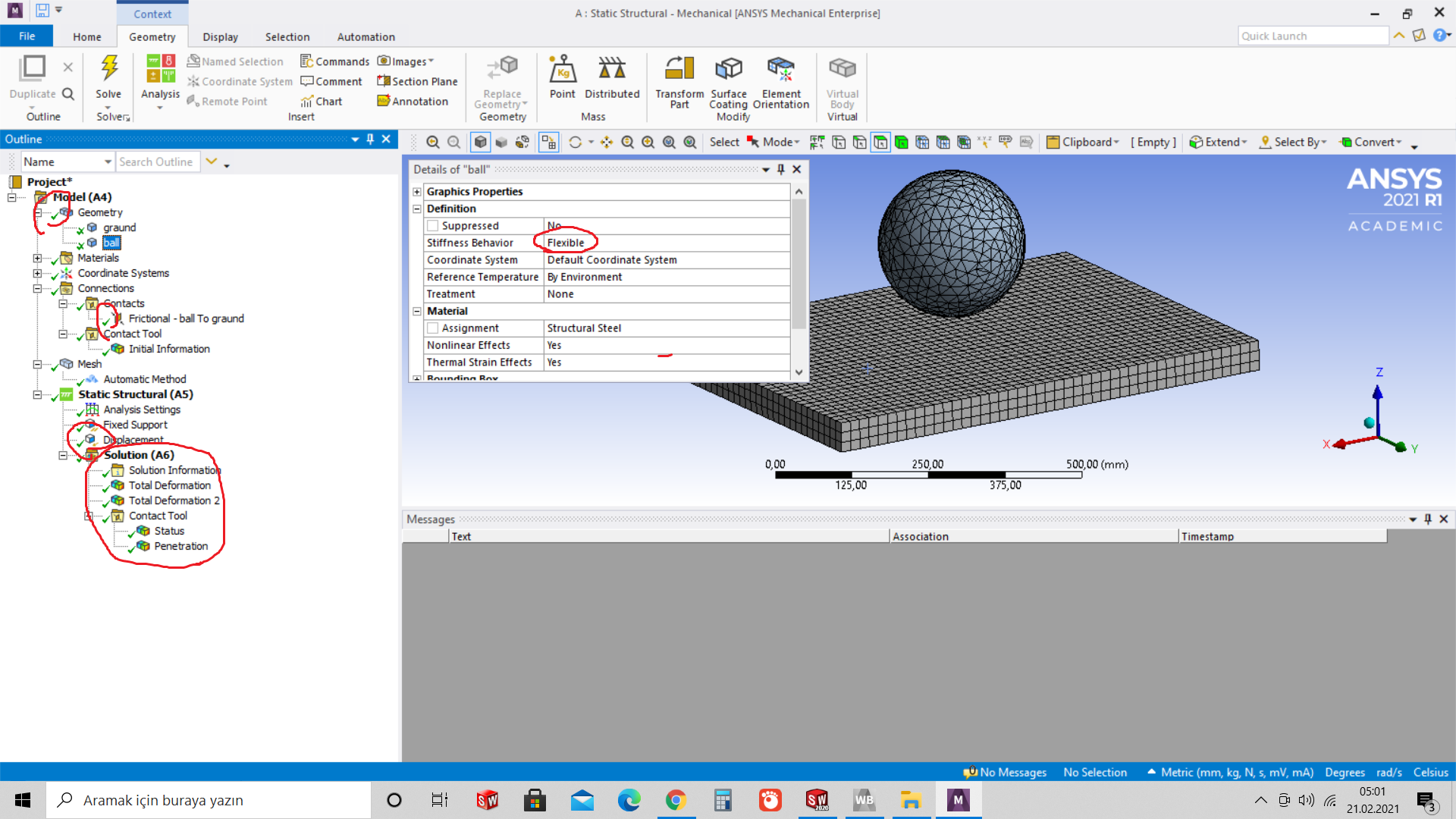

cemal
SubscriberFebruary 21, 2021 at 11:12 ampeteroznewman
SubscribernFlip the Target/Contact sides on the Contact. Rigid body must be a Target surface.nFebruary 21, 2021 at 2:22 pmFebruary 21, 2021 at 7:18 pmpeteroznewman
SubscribernThe default Contact Formulation doesn't work with a rigid surface. Change it to another formulation. I don't recall which one works, but you will know you have a valid one as soon as the yellow goes away.nViewing 3 reply threads- The topic ‘Hi thanks for your help , stiffnes behavior : flexible there is no mistake. stiffnes : rigid error’ is closed to new replies.
