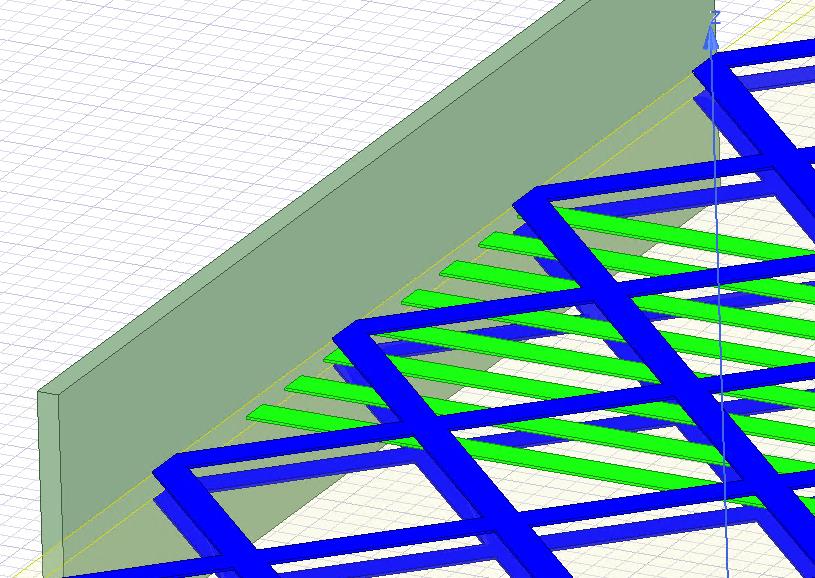

in this pic,
blue is ground plan, and green is signal lines.
this scheme is stripline but ground has apertures
and left side ,That is PerfE, and I set wave port at right side face in PerfE box , in DrivenTerminal
wave port is bigger than substrate height, because signal line has radiation upside at aperture part in ground plane.
but I got error messages see the sentences with underline
  [info] Parametric Analysis on ParametricSetup1 has been started. (8:17:07 ?? 6 15, 2020)
  [info] A variation (wave_port_z='0.1335mm') has been requested using the following machines: Local Machine. (8:17:08 ?? 6 15, 2020)
  [error] Port refinement, process hf3d error: Too few conductors were found on port 1. There should be one conductor for each terminal, with one additional reference conductor. Unintentional contact between conductors may cause this error.. Please contact ANSYS technical support. (8:17:13 ?? 6 15, 2020)
  [info] A variation (wave_port_z='0.5mm') has been requested using the following machines: Local Machine. (8:17:14 ?? 6 15, 2020)
  [info] Port refinement, process hf3d: Port '1' has 14 signal conductors with 8 terminals. More signal conductors than terminals can adversely affect the terminal transformations. Please verify conducting boundaries and objects are correctly assigned and touch the port. (8:17:19 ?? 6 15, 2020)
How should I set wave port in better way?

Ansys EmployeeHi,Â
It seems like you have selected multiple conductors while defining the port. Make sure that only one conductor has been selected as a signal trace.
Please refer to differential pair or stripline example in HFSS.Â
I hope this will help.Â
