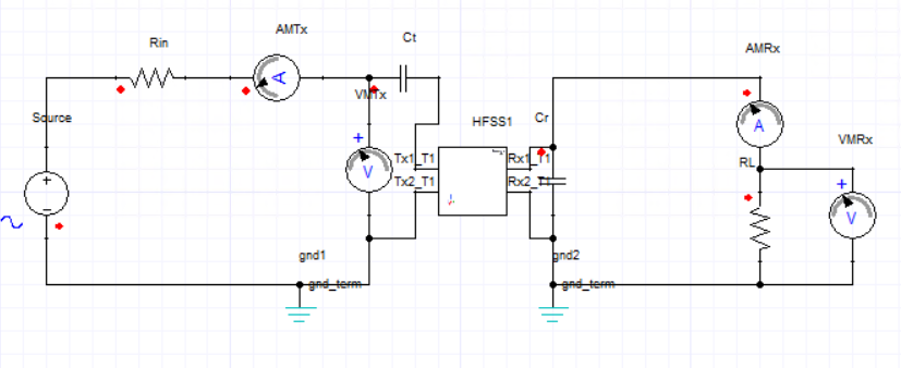

      Hello
      I am trying  to do an AC simulation in Simplorer with a component from HFSS but I am getting this error from simplorer "Failed to get data from design".
      I used "Add HFSS dynamic component" to import the matrix
      Thanks,
      Miguel
    • Aymen Mzoughi
      Deleting the HFSS design from within Simplorer, removing unused definitions (Tools -> Project Tools -> Remove Unused Definitions) and re-inserting it might solve the problem. Make sure the HFSS design is running correctly and the results are there.
