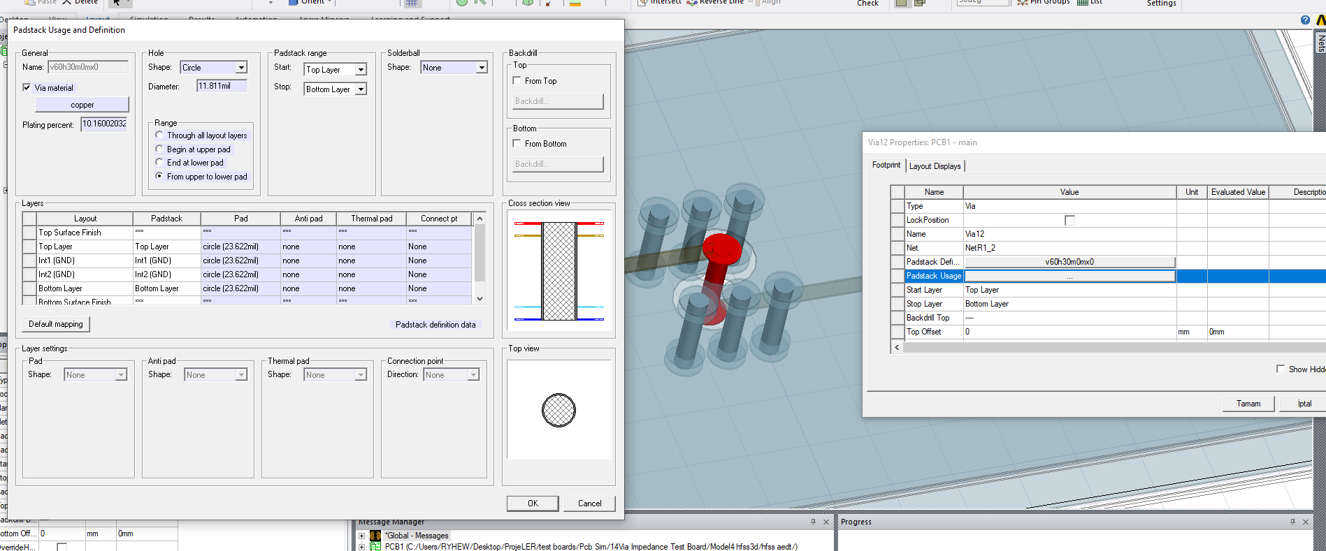

Ansys EmployeeSuch vias cannot be configured in HFSS 3D Layout. Since it is possible in HFSS, I recommend converting the design to HFSS model and simulating there.
How to export a design from HFSS 3D Layout to HFSS 3D Classic:
1. define an HFSS Solution Setup in the HFSS 3D Layout design
2. right click on the HFSS setup name in the Project Manager window and select Export -> HFSS Model...
