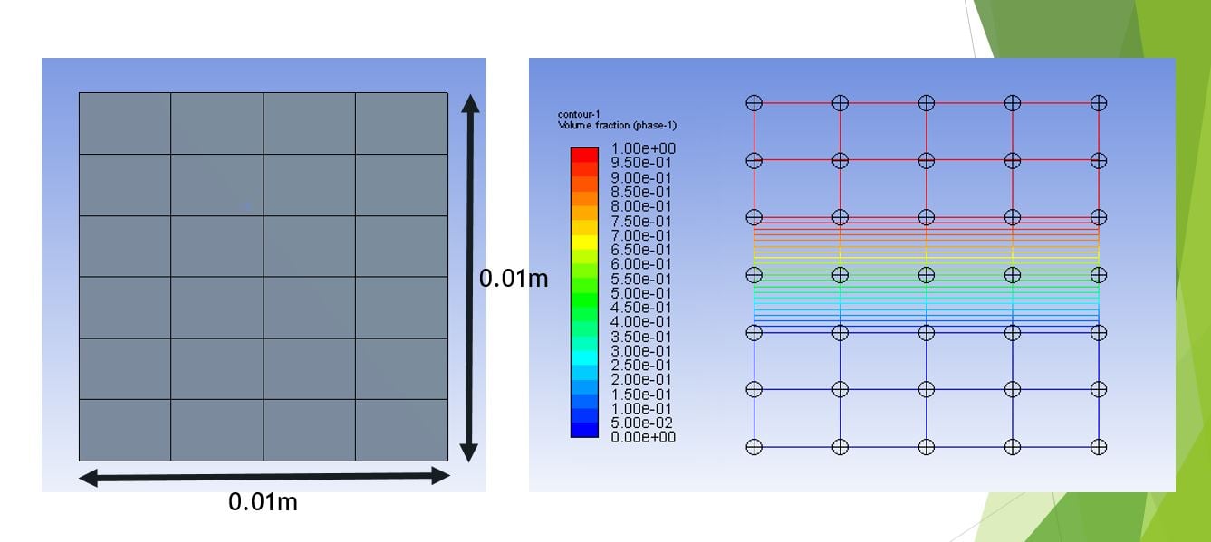

      The geometry is defined as:
      Are the results correct?

      1. Now how to convert Area1(area density) into the interphase area? The answer should be Area= 0.01m, since it's in 2D, the area should come as a line!
      2. Is my patching correct? Why is it not showing a sharp interface, although I have used a sharp interface!
    • Amine Ben Hadj Ali
      Is this something you require in Fluent: We can help here on things related to usage and deployment of our software.
      For point 2: interfacial area is well spread over interfacial cells. For VOF always show cell values. Your grid is anyhow very coarse.

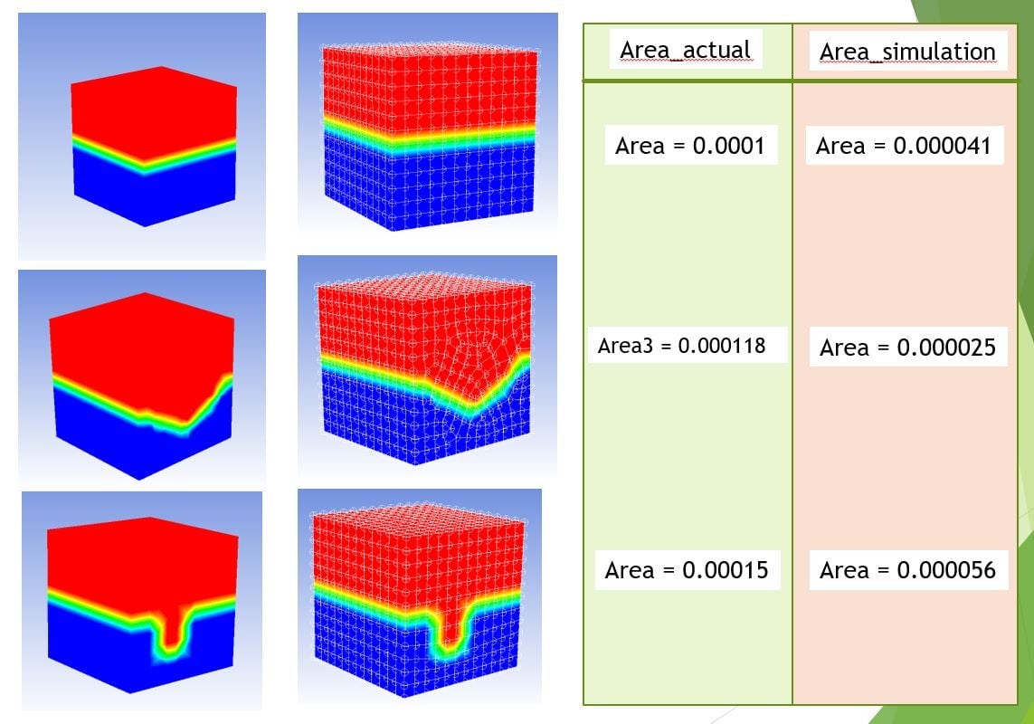

      But I'm getting some errors, may you please look at this table: ( I've checked my UDF on 3 different geometries but the result are not coming correct! ), Can you help me with this! Thanks!
      Are you running the cases in parallel can you make a cell counter dummy? Can you just sum the udmi in Fluent directly? I am in solved in a project where interfacial area is well predicted ( with some more lines it matches better.)

       Area = 0.000049,  (It's from case 3, where previously it was around 0.000056 but then I refined the mesh so it comes to a bit different )
      sum = 59081855.621884 ( sum of UDMI )
      count = 106926 ( counter )
    • anshs
