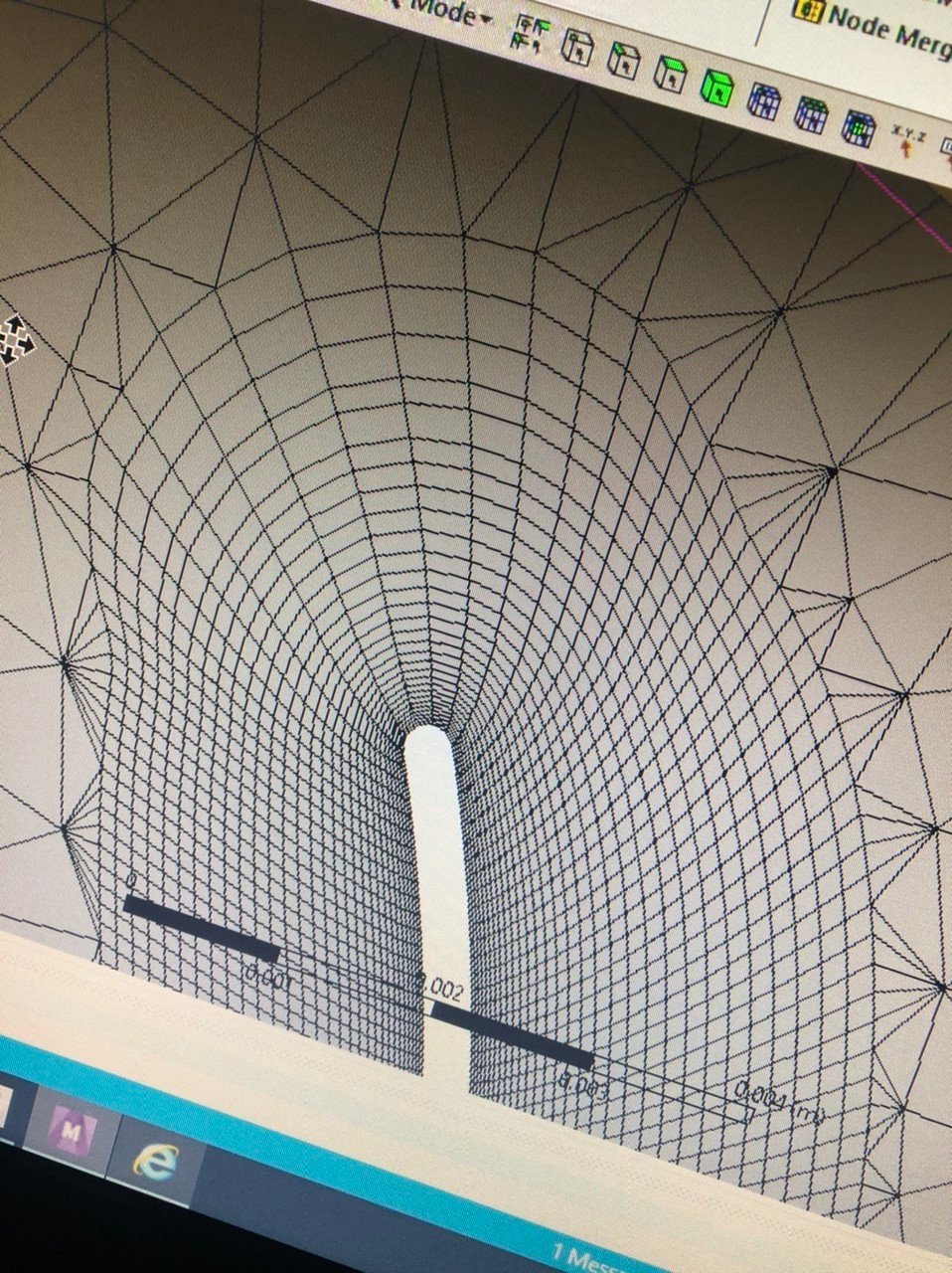

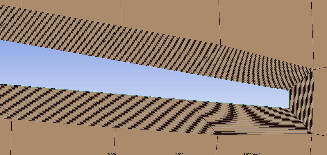

      Hello
      I am trying to create an inflation for this blade but despite using the Total thickness option, layers at the tip are thicker and the overall inflation is distorted there.
      I attached photos of the inflation for different sizes and as you can see the finer i make it, the bigger the differences is.
      Any ideas?

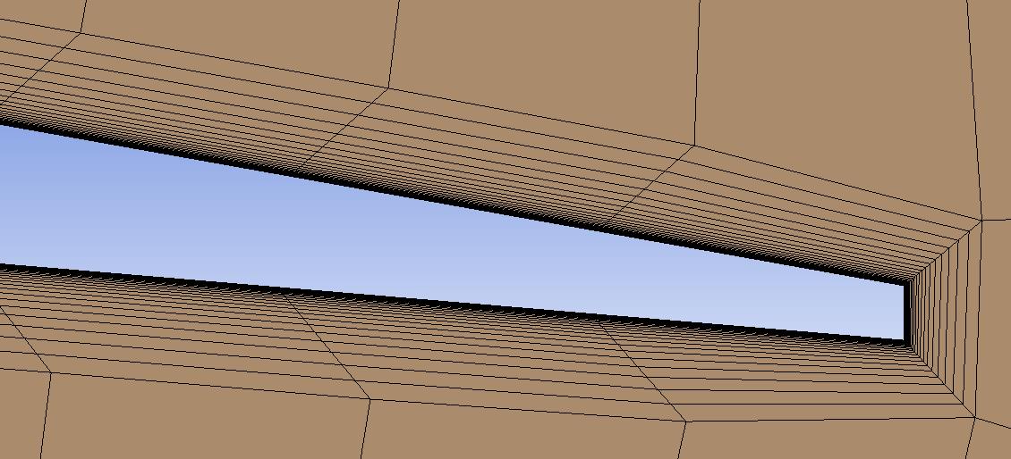

    • mahereid97
      Oh I am really sorry, seems like this option was not available on my phone.
      Anyway these are the images. As you can see when the number of layers and and number of divisions on the blade get larger, the difference is more visible. I want my mesh size to be similar to the last image (the finest one) but with layers of constant thickness.

    • mahereid97
      Does the mesh size outside the inflation affect the interior layer thickness? Anyway mesh size is constant all around the blade, and even if I make it larger or smaller it does not solve the problem.
      And the images have different total thickness to show you that the difference gets worse when it increases.

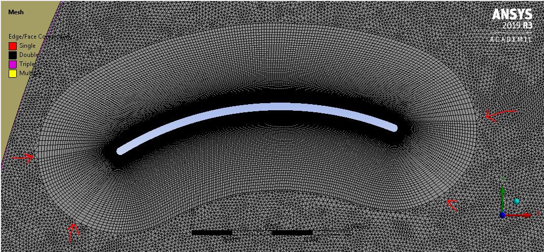

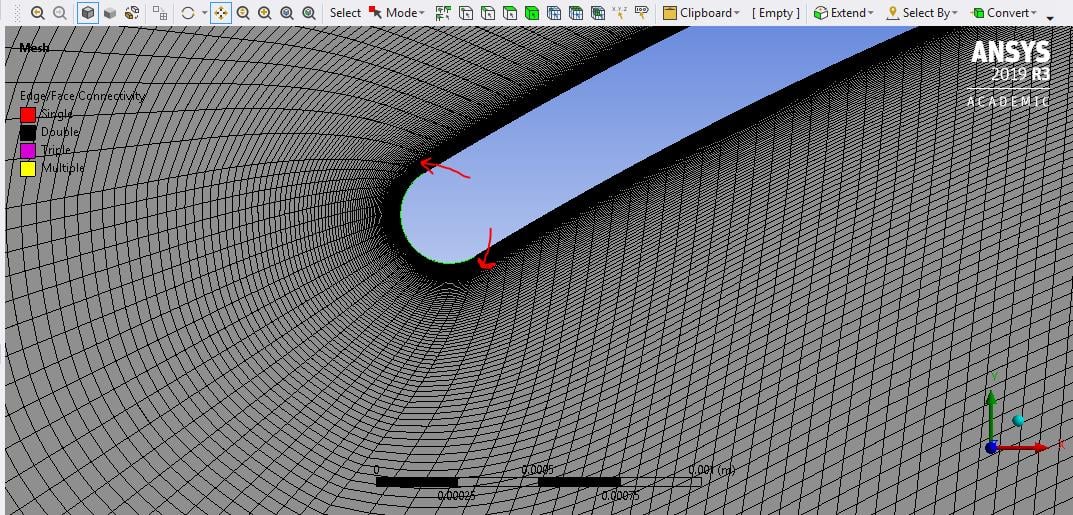

      Upon digging in the mesher settings, I found a parameter called Max height to base ratio in the advanced options of the global inflation control. Turns out this number is set to 1 by default which means layers stop increasing in height when their height/base reaches 1. In my case the big curvature difference forces some layers to stop growing causing the big distortion we see.
      I fixed that problem by increasing the Max height to base ratio to 2.
      I want to finally ask you if you if there's advanced options for biasing an edge sizing feature. As you can see in the images below, the couple cells next to tips grow quite large. I need some sort of geometric or exponential bias factor instead of the linear default one. Is something similar available?

    • mahereid97
      The problem is not the difference between the inflation size and the tet element size outside.
      The first problem was that the inflation layers stopped increasing in height in certain locations causing the overall thickness to be non-uniform.
      I worked that out by changing the max height to base to 2 instead of 1.
      Now the new issue is that just next to the tips, the length (not height) of the layers are bigger than the rest. I need something to control element size.

    • Karthik Remella
      Administrator
      Please use an edge sizing on the curved edge. Please specify the number of divisions or edge sizes. Either one should work. This would help you capture the curvature better.
