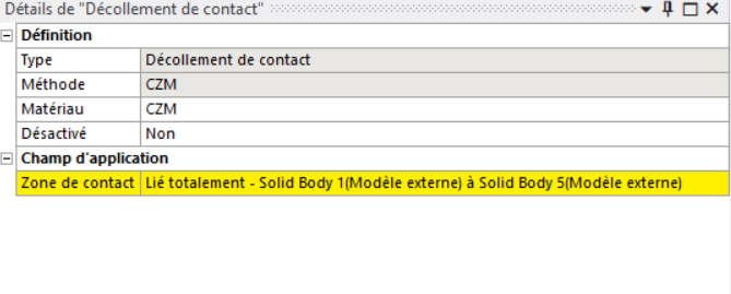

      Here is the detail window which gives me when I select all the contacts.

      After defining the properties of the CZM, I insert the fracture ==>  contact debonding ==>  I assign for each contact debonding the corresponding contact as shown in the following picture:
      sorry, the screenshot is in French language
      Rupture = Fracture
      Décollement de contact = Contact Debonding
