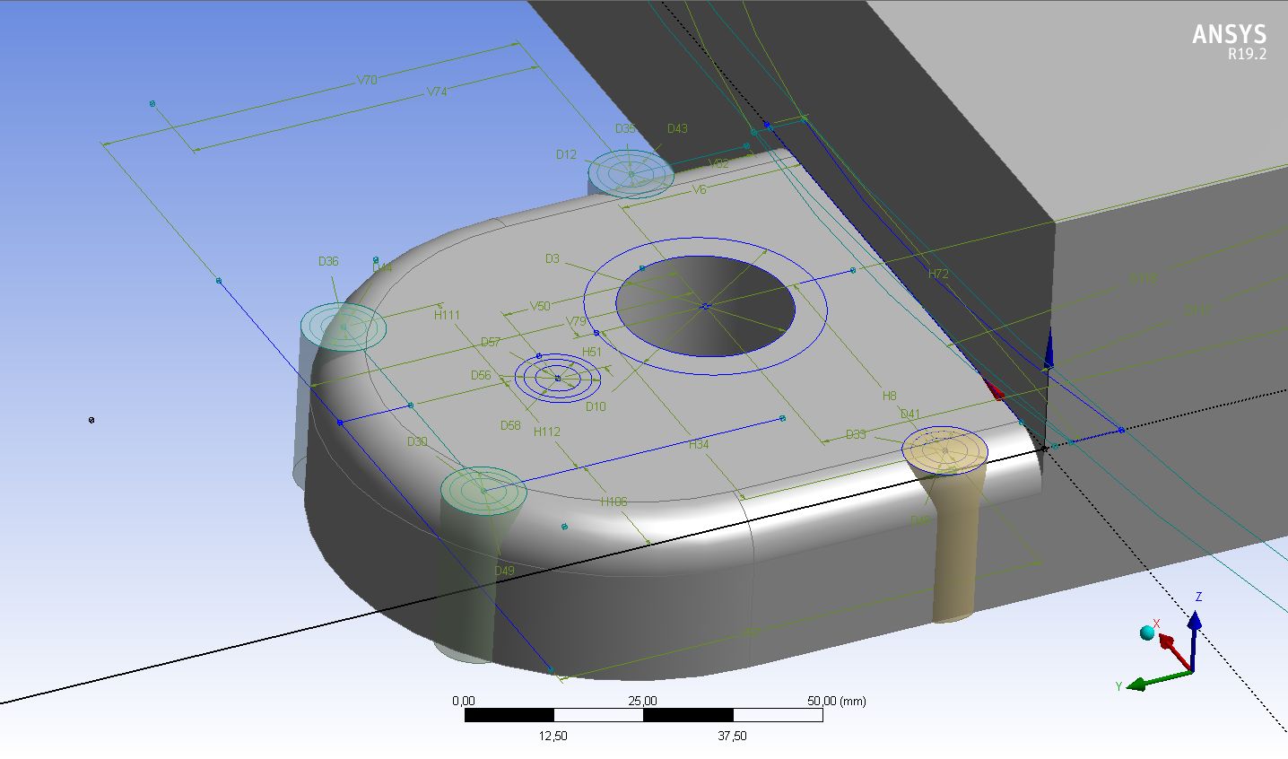

Hello, I have a huge problem to make a radius into one model that is shown and obvious.
    • Georgiro
      Hello, I have a huge problem to make a radius into one model that is shown and obvious. And I think you will have a clear idea to change the desing and make the radiuses. You can see the green lines that are showing the areas of interest.
      Thanks
    • FrankD
      Georgiro
      You can try using variable radius rounds to get the desired shape, but that is difficult geometry. You would have a much better result from building your small cylindrical bosses taller, then fitting the convex rounds in, then cutting the bosses back to the desired height, and then rounding the result with the tiny rounds.

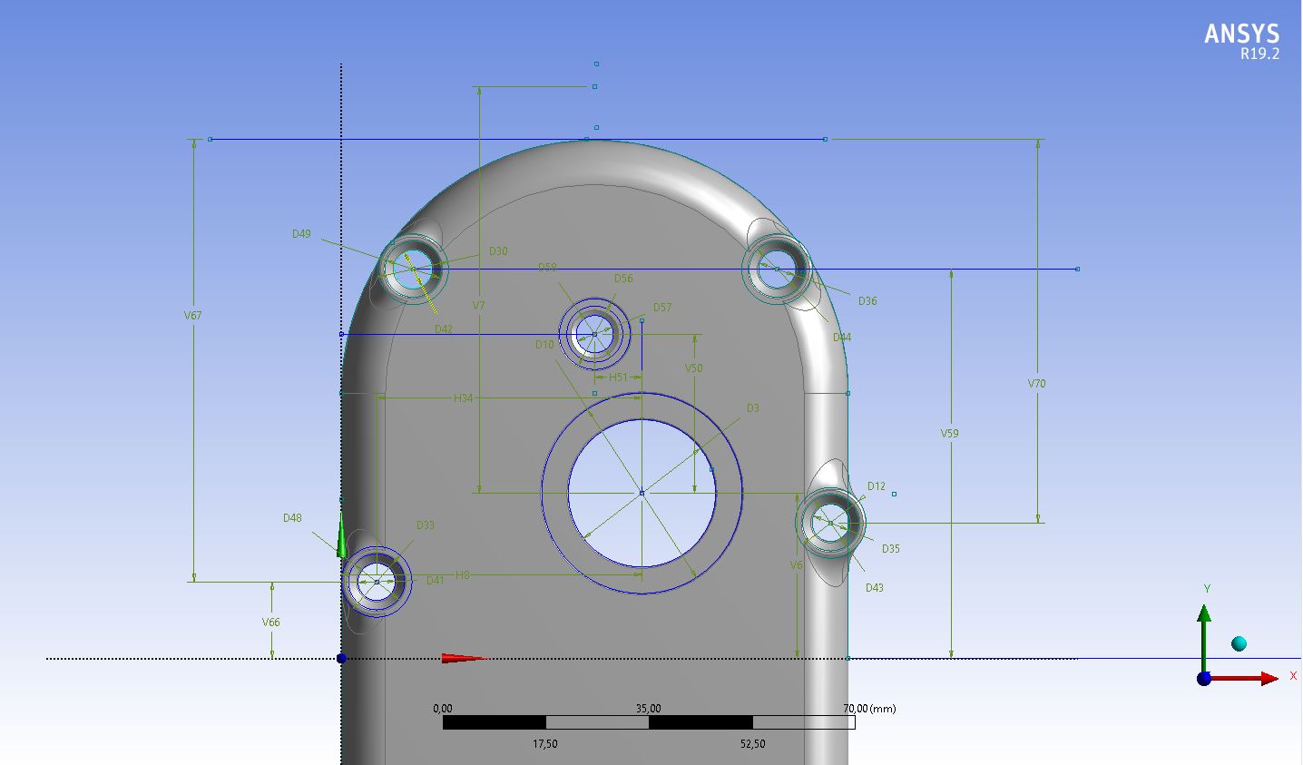

    • Georgiro
      This is the latest  view.

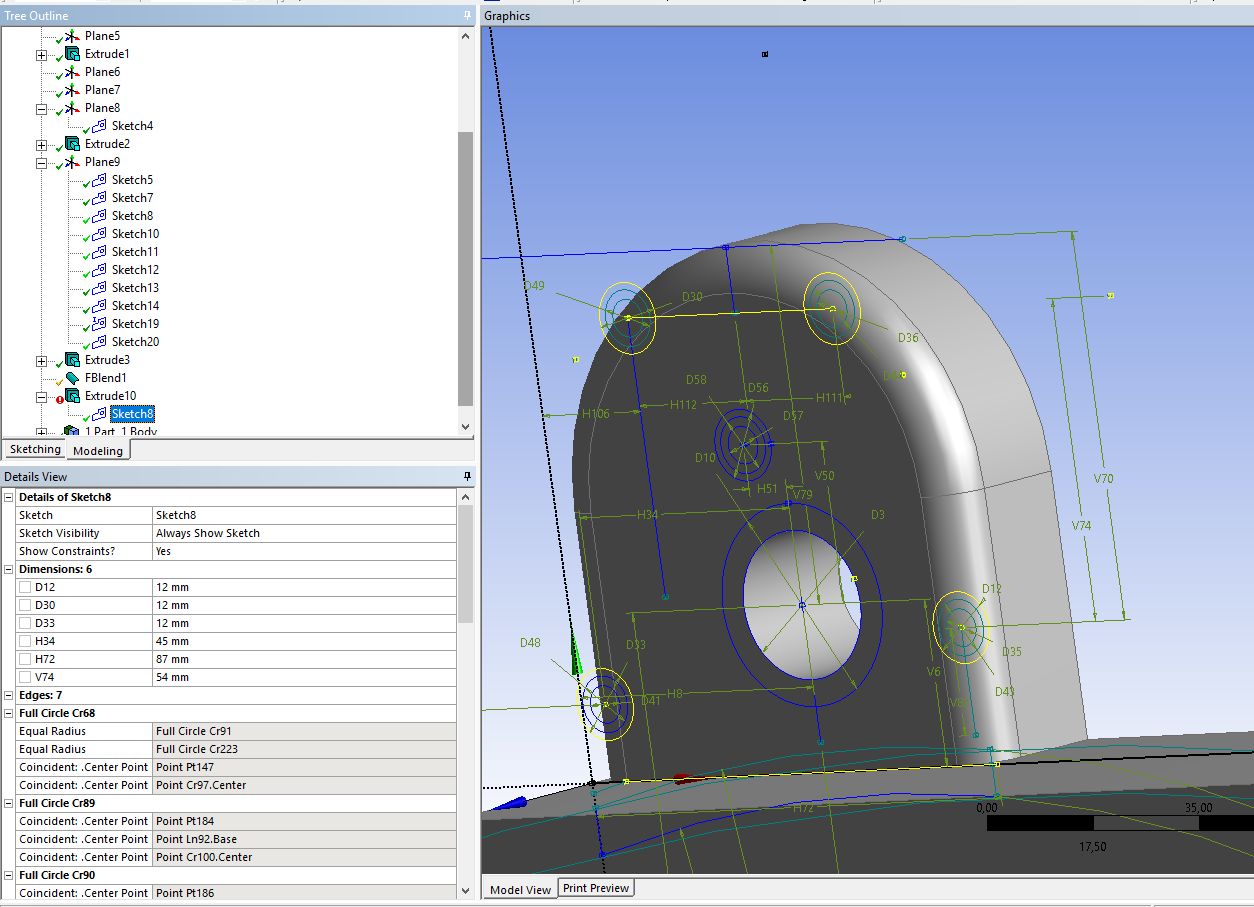

      And here you can see what I can show you and it has only Add frozen value, otherwise nothing works. So can you help me what to do with it?

      Is there an error associated when you try and add the cylinders?
    • Georgiro
      It does not do anything, but in the picture you can see what is shown, so it is frozen only, otherwise it does not work at all. So I have no idea what to do with it.
      Thanks
      If the operation fails it'll have a red mark against it. Right click on the operation and see if there's anything about why it's failed.

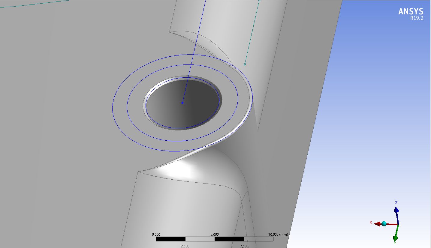

      So now it works, but not absolutely well, since if I need to create an edge chamfered, it does not work. And now you can see that I have created a blend of the edge - it is small, but it is impossible to create it. Do you have any idea how to do it? Thanks
    • Georgiro
      So now I am trying to do the chamfer with only 0.1 mm and it shows this on the picture below...incredible
      That looks to be because you've got the cylinder too close to the edge: the chamfer is trying to blend to either create a too complex surface or a physically impossible shape.
