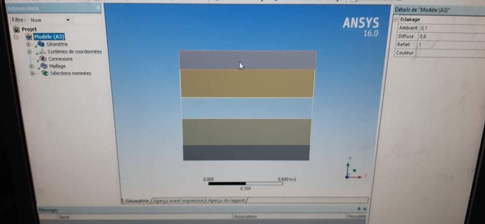

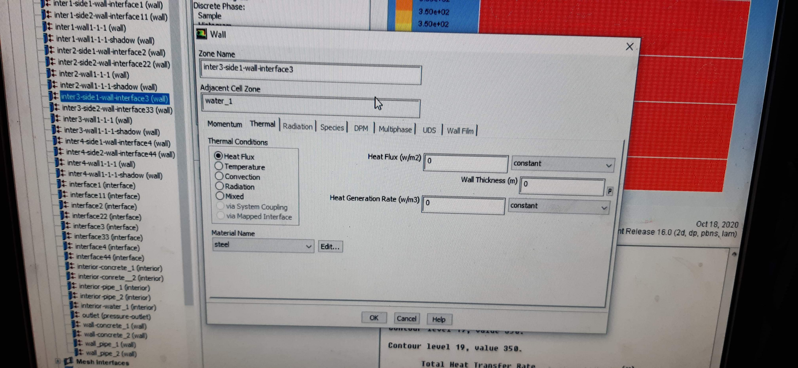

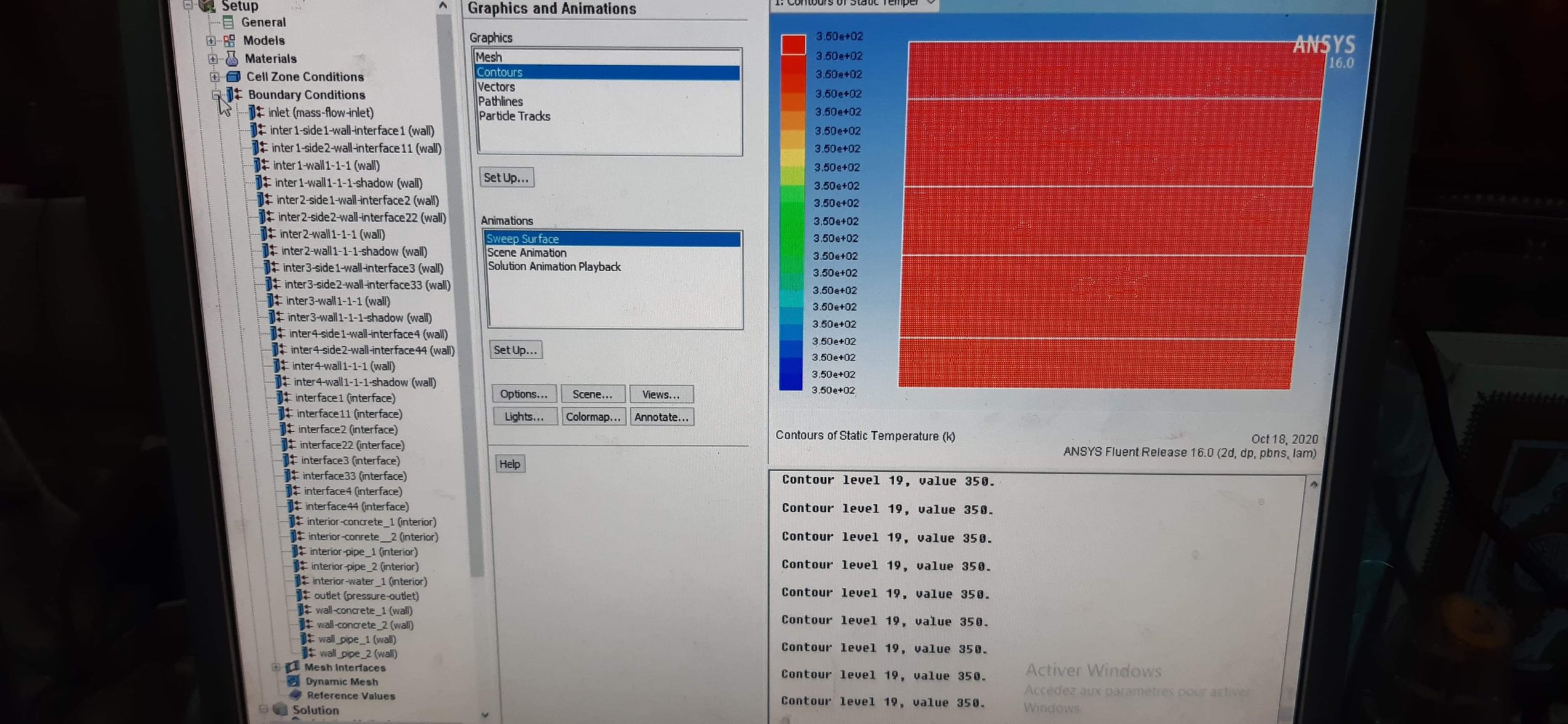

      nI want to simulate water flow inside a pipe of steel.covered with concrete, i do the simulation in 2D. I create one part, i identify the interfaces between water and betwen the other materials, when going to the fluent setup for the interface between the pipe and water the material is steel, but when runing the simulation the results are not good it temperature of water remain constant the same for all other materials. Here are some picture of my problem and thank you so muchnnn
      nI suggest you start a New Discussion. It is confusing because your problem is different than the original poster's problem.nPlease reply with a simple hand sketch of the water, steel and concrete cross-section. Label the temperature and flow rate of the water. Label the thermal boundary condition on the Concrete. Mark the radius of the water, OD of the steel and OD of the concrete. Mark the length of the pipe.nI assume you are looking for a steady state solution.nYou should make this model as an axisymmetric model. That means the pipe centerline lies along the X axis and you draw a rectangle for the radial dimension of the water on the +Y axis. Make another rectangle for the steel, then a third rectangle for the concrete. Don't draw any rectangles on the -Y side of the X axis.nIn your replies, if you need a screen snapshot, use a screen capture program like Snipping Tool instead of using your cellphone camera.n

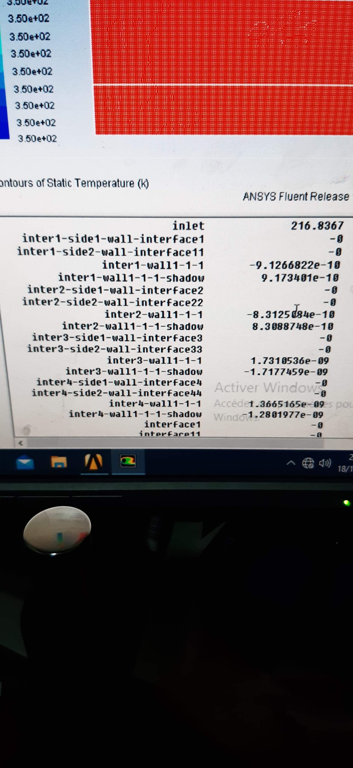

      nits just a simple model which doesnt work, my real one is not symetric, it's composed of multiple layers, with this one which is simple i dont get good results always the energy residual starts from 10e-16. moever the interface between the pipes and concrete is generated in setup as interior i dont know why.nthank you sir for your helpnn n
