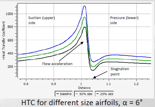

I am currently trying to post-process HTC data for a 3D wing on FENSAP. However, I have encountered the issue that the data is not directly available from the VIEWMERCIL tool.
During the 1st icing workshop, I saw a graph presented by Isik Ozcer which is relevant to my research. Could you kindly inform me of the steps and equation used for generating the graph?
Thank you for your assistance.

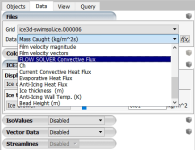

Ansys EmployeeHello Zaher,
Thanks for your kind words and comments. Regarding your query, when you open your ice solution, the field to select is "Ch". This can be seen in your screen shot. Hopefully this answers your question.

SubscriberHi Shoaib,
Thank you for clarifying my doubt about "Ch". I wasn't sure if it was an abbreviation of HTC or some other field, I hope this helps others too.
