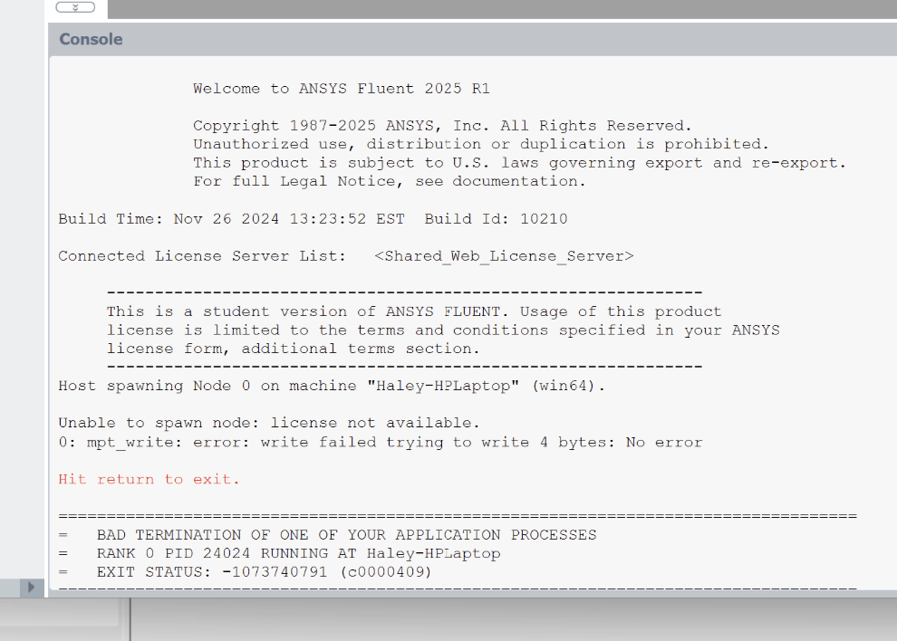

    • hotting
      I am having similar issue. I deleted this file but when I run Fluent, I get an error saying "Unable to spawn node: license not available.". I have run Mechanical and it worked fine, but Fluent will not work
      • Rajeshwari Jadhav
        Share screenshot of error
    • hotting
    • Rajeshwari Jadhav
      How are you launching it, you can use only 4 cores in student version.
      Can you share your launcher's screenshot?
    • hotting
      Oh okay. I was told by my professor to use the amount I have on my laptop. I had 14 entered. Let me try it with only 4
      • hotting
        Yep, that fixed it, thank you so much!
