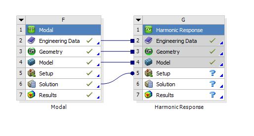

      Make sure you have coupled the two (see image below), That is in order to do a harmonic analysis one needs to calculate the modes first (for mode superp. option) which can be then used by the harmonic analysis. If that is done in the harmonic analysis settings there should be a section for Rotordynamic controls (see yellow marking below). I think though to use the Coriolis effect (Rotrod. Controls), one needs to use the full solving method (thus modal and harmonic needs not to be linked like shown below, only a harmonic analysis is enough, one would still see the Rotrod. Controls though).
      If this does not help feel free to upload your model or some screenshots of what you are missing in the harmonic settings.

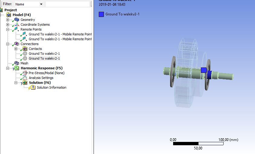

    • raffikko
      Ye, but I don't have this rotating force in my loads tree. Please look on photo:

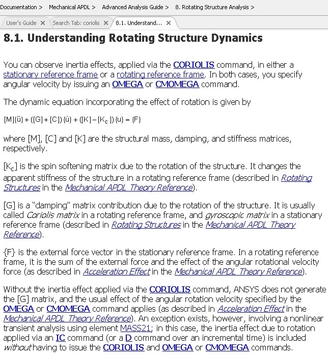

      Rotating Force was added after Release 15. You will have to use APDL commands such as CORIOLIS and OMEGA to define angular velocity input to the rotating structure. Here is the section in the ANSYS 15.0 help
      Here is a command object inserted with these commands

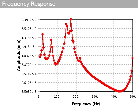

      Here is the Freq. Response in Y with the command snippet. It is the same magnitude in Z.

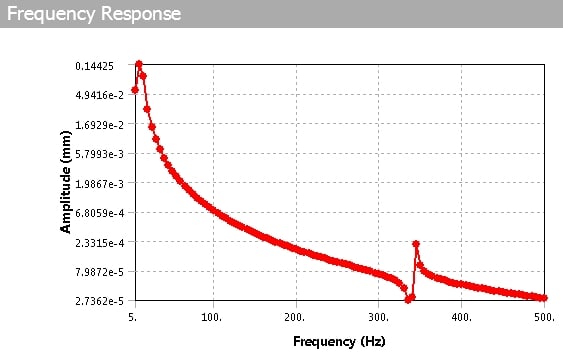

      Here is the Freq Response in Y without the Command Snippet. It is 1000 times smaller in Z.
      You can create Force in the Y direction (assuming your shaft is along the X axis). It is sufficient to have a single unbalanced force since it is rotating.
