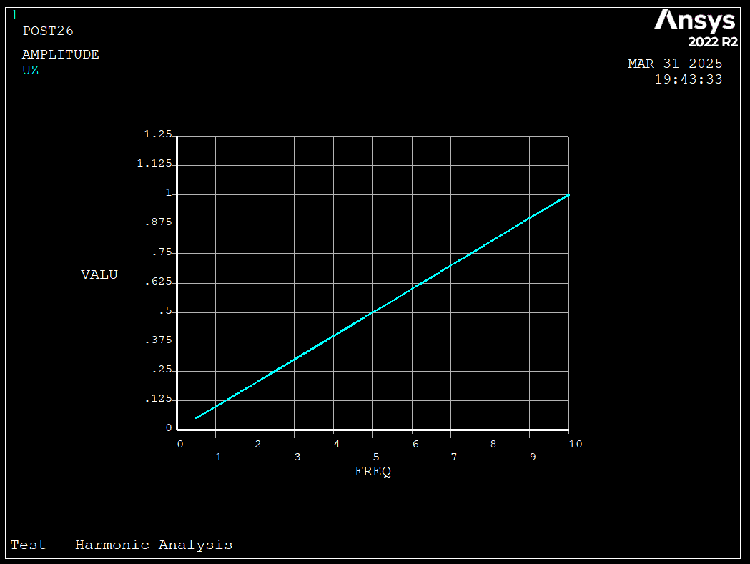

      Greetings,
      I set up a simple harmonic simulation in MAPDL of a model of a block that is excited from one end with a harmonic displacement in the Z direction (1 meter amplitude), and I am recording the frequency response function of a node in its tip. If I am imposing a harmonic displacement in one end, logic tells that the displacement frequency response of the opposite end should have the same amplitude for a 0 Hz or very low frequency (below the first resonance of the structure). Nonetheless, I am not getting such a response, I am obtaining a zero-displacement response that increases linearly with frequency, which does not have a physical meaning for the presented problem. What could be the problem? I tried the same setup using the regular ANSYS Mechanical interface, and the results of displacement at low frequencies do match the imposed excitation, which indicates that there is a problem in the APDL script.

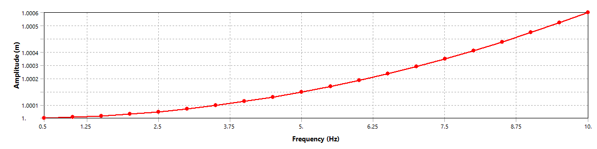

      Additionally, this is a picture of my output FRF. Vertical axis is the displacement in [m] and horizontal axis is the frequency in [Hz]
      For the same setup in Mechanical UI, I obtained the following results, correctly representing the expected behavior:

    • dlooman
      The (not very good) default in APDL is KBC,0 which ramps the unit displacement from zero vs frequency.  In Mechanical, KBC,1 is set by default.
      • jesusepp
        I applied the adjustment (KBC,1), and now the results match! Thanks for the support
