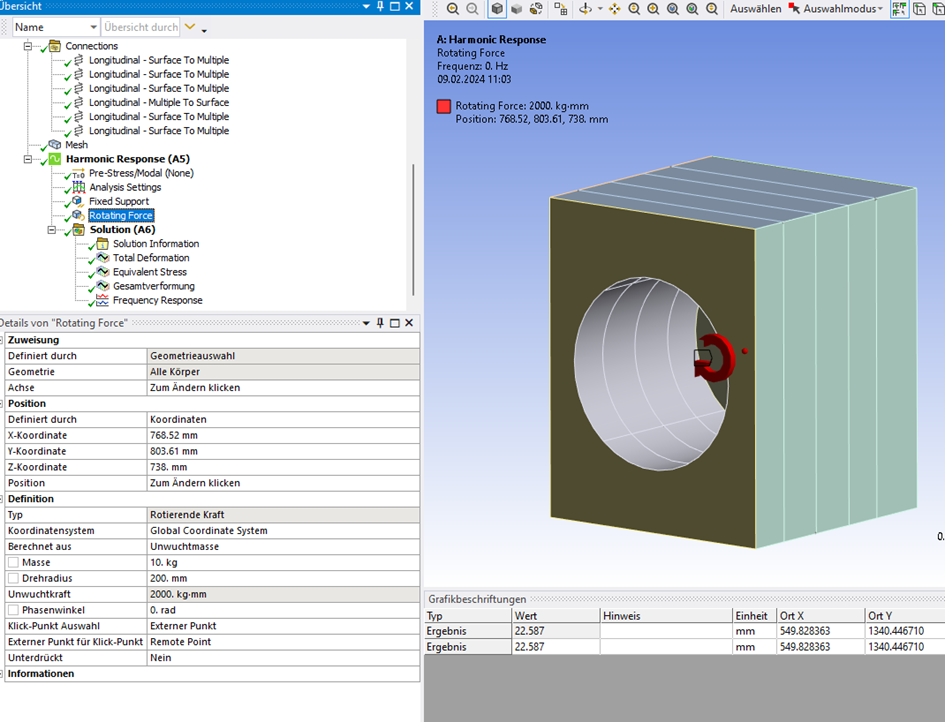

SubscriberIn the ANSYS Innovation Courses, under Mechanics/Forced Frequency, there are examples of rotor dynamics with non-rotati
ng structures (SE04 washing machine frame analysis). Is it permissible to introduce a rotating force to all parts (including non-rotating ones)? Shouldn't an APDL snippet with SYNCHRO command be applied in this case?

Ansys EmployeeYes, that appears to be the only way. After specifying a rotating force on "All Bodies", the ds.dat has the commands below. Your commands will need to overwrite those commands, perhaps by redefining the commponent, cm_synchroComponent. Not sure if it it's necessary then to reissue the synchro command, but it wouldn't hurt. Do a small test to be sure it's working.
/com,*********** Component For Rotating Forces ***********
/com, Component For : All Bodies
esel,all
cm,cm_SynchroComponent,elem
/com,*********** SYNCHRO & CMOMEGA For Rotating Forces ***********
synchro,,cm_SynchroComponent
