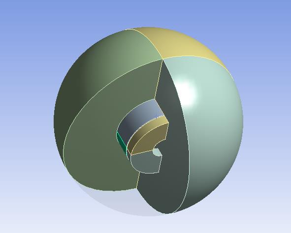

      Thank you for the recommendation, I used the three orthogonal planes to split and share all the geometry, both acoustic and mechanical components, but the meshing still failed.
      I believe the problem may be the very small air gap areas surrounding one of the mechanical components, this is reflected by the picture in green. I have tried contact size meshing for these small areas in contact and I've also tried some inflation for the areas of concern but neither worked.
      I've attached some pictures to described my issues. Please let me know if you see any problems or if I should try another method to generate the mesh.
      Thank you,
      Nathan
    • Keyur Kanade
      i suggest you to take only quarter of the domain for debug purpose.
      try to mesh only quarter. if meshing fails, right click on error message and select show problematic geometry. please observe the location carefully and make modifications at geometry or meshing controls.
      once you could mesh quarter of geometry, you can apply similar strategy to entire domain.
      Keyur
       Nathan, I agree with Keyur that you should initially work on a small piece of this.
      I expect you are correct about the source of the problem. I expect those thin "petals" an important part of the model.
      I can see that the sphere has not been sliced by the third plane.
      In any case, if you want to share your model, you can right click on the Mesh and Clear Generated Data, then File > Save, then File > Archive and then you can attach the .wbpz file after you post a reply as long as the file size is < 120 MB. Say what version of ANSYS you are using in your reply.
    • NathanEmery
      Thank you both Keyur and Peter for your suggestions, I edited the mesh appropriately and figured out the meshing issues with the small air gaps.
