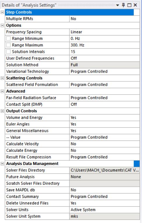

    • mach1991
      I attached a screenshot. From the tab of my solver detail, which option should I change? I can't find the option of "Solver type"
    • Ashish Khemka
      You might need to use Commands (APDL) object to change the solver type. Please refer to the following link which talks about different solvers available for Full Harmonic Acoustic analysis:
      https://ansyshelp.ansys.com/account/secured?returnurl=/Views/Secured/corp/v201/en/ans_acous/acous_solve_analset.html%23acous_solve_harmset
      In this link refer to the following section:
      10.1.2.1.2. Specifying the Analysis Solver
      You will need to use the EQSLV command. Hope this helps.
