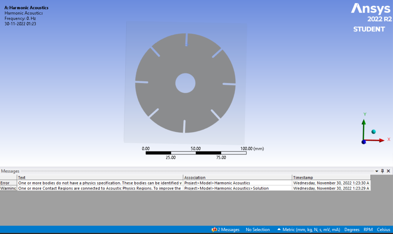

We have physics regions in acoustic analysis - these can be either acoustic or structural regions. So all of the bodies need to have these regions defined, and you are missing one. So assign one to all bodies.
See here where they have both regions defined:
https://www.youtube.com/watch?v=H4xuNbI6yZg
Erik
