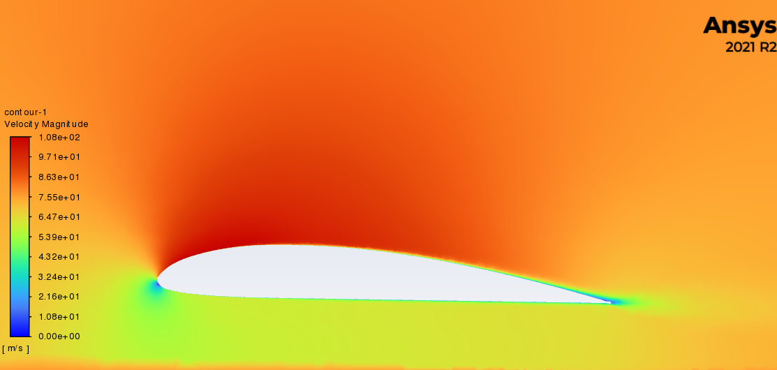

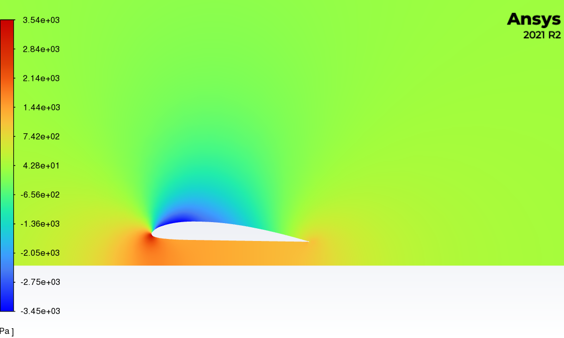

SubscriberWhen simulating a 2D airfoil in fluent, i get a CD of around 0.05 which seems sensible but get a CL of 2.6 which seems too high. When i alter the angle of attack to 3 degrees the CL goes upto 6. I have set the ground to the same velocity as inlet as its in ground effect. Any help of why my CL is so high woud be appreciated

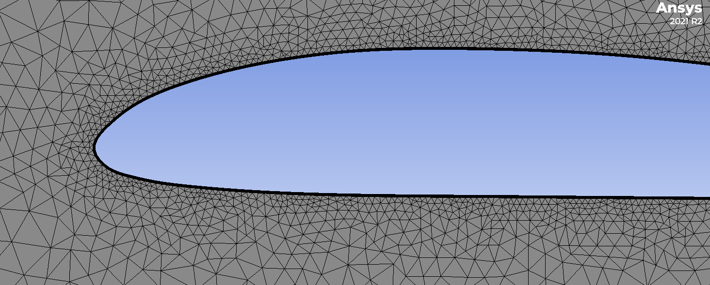

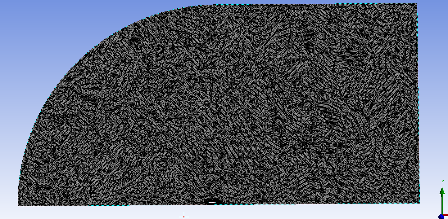

SubscriberHi Rob No i haven't created a higher pressure region under the wing. I have created an inflation layer on the airfoil and done the rest of the free stream as unstructured. I believe in the setup the settings i have used are correct, i have set the inlet velocity, set the outlet as a pressure outlet. I have set the reference value as the inlet and selelcted CD and CL for the airfoil. My max Yplus is also 0.7 on the airfoil

Forum ModeratorWhat's the pressure & velocity look like around (and under) the wing?
April 5, 2022 at 3:05 pmApril 5, 2022 at 3:06 pmApril 6, 2022 at 2:32 pmRob
Forum ModeratorThat looks a fairly sensible result. Ground effect vehicles work by riding on a sort of air cushion so can carry very high loads. If you get too high you lose the effect and you need to hope the effect re-establishes before you hit the floor.

April 6, 2022 at 2:36 pmMCFDHELP
Subscriberyes i thought these contours looked sensible but the CL was 6 which seemed too high hence i doubted the validity of the contour plots. I was hoping to show the CL decreasing as the height increases from the ground but wasn't expecting a CL of 6
