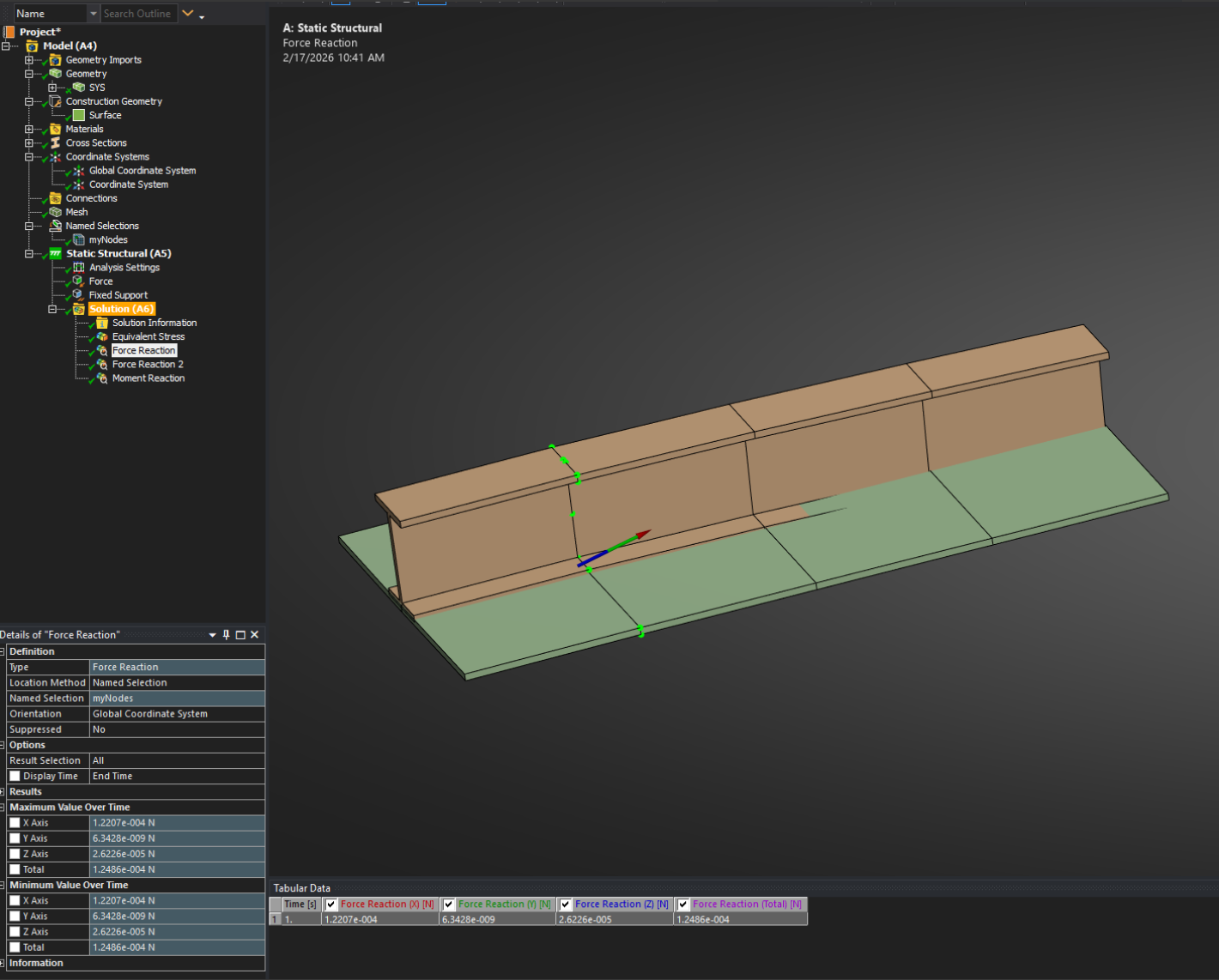

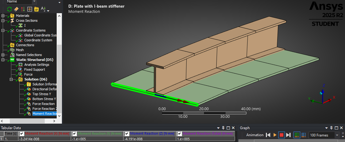

SubscriberNastran provides very little output unless you specifically request it. Ansys provides lots of output unless you specifically turn it off, however Nodal Forces is one output that is off by default so if you are solving in the Workbench/Mechanical environment, go to Analysis Settings, Output Controls and Set Nodal Forces to Yes before you solve.

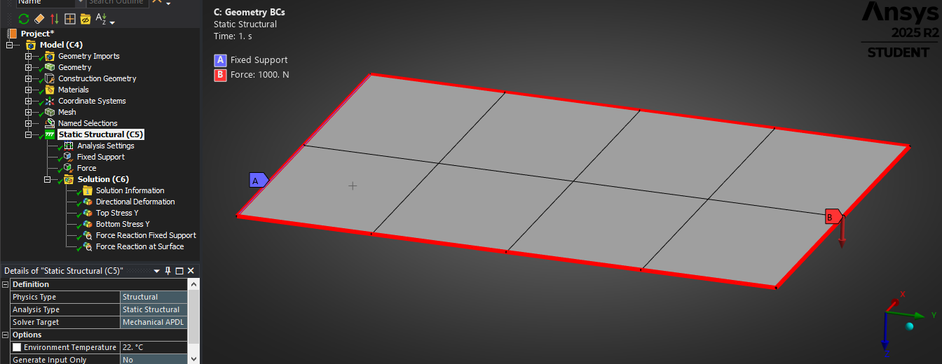

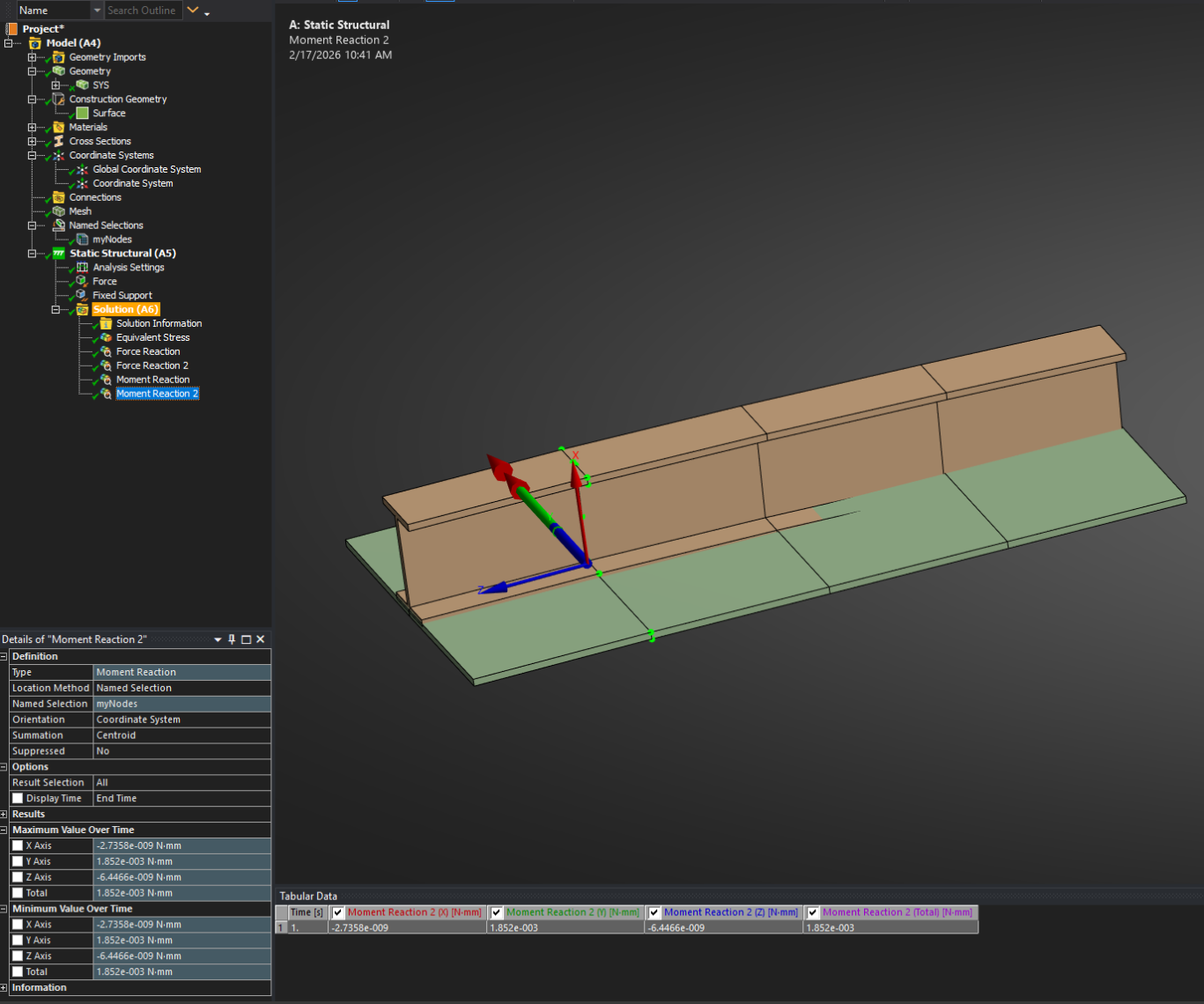

Here is an Ansys model with the same loads and boundary conditions you show, which are generally applied to geometry in Ansys Workbench/Mechanical.

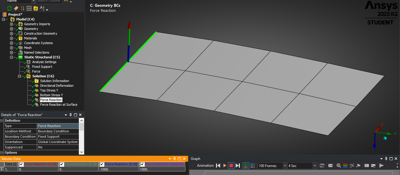

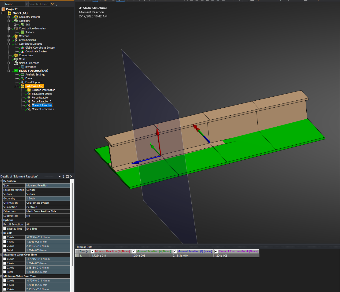

There are two places you might want to sum up the Nodal Forces (Grid Point Forces in Nastran): 1. At boundary conditions and 2. at an arbitrary plane.Â
To get the sum of Nodal Forces at a boundary condition,under the Solution branch insert Probe > Force Reaction and select the Fixed Support BC.

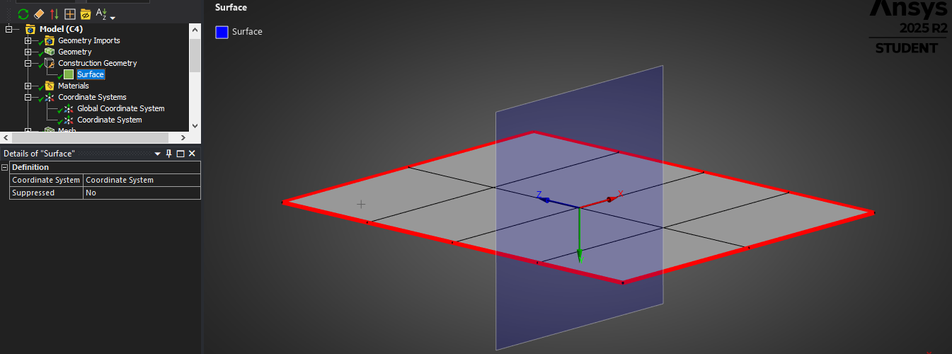

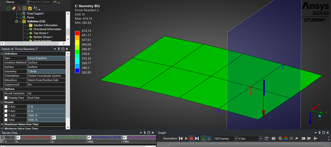

To get the Nodal Forces at an arbitrary plane, first insert and position the XY plane of a coordinate system where you want to cut your mesh. Then under Geometry insert a Construction Surface using that coordinate system.

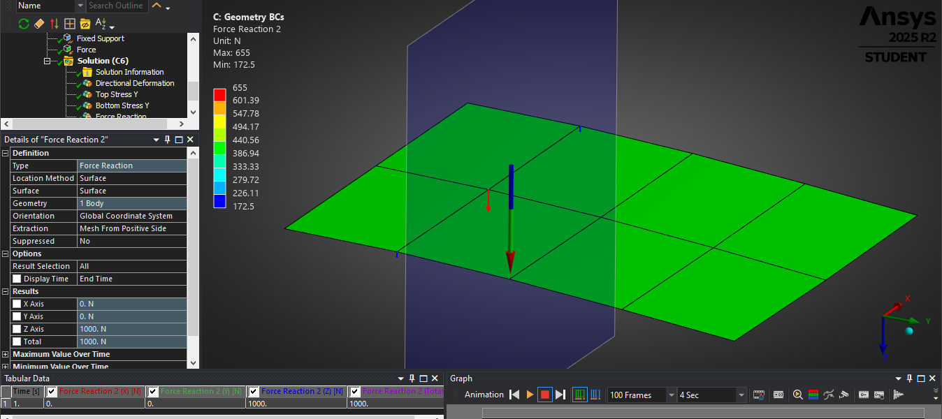

Then insert another Probe > Force Reaction result, but change the Location Method to Surface, pick the surface then pick the Geometry that was meshed and select the Extraction to be on the Positive side or the Negative side of the surface. Below you can see the color code on the three nodes are 442.85 N at the center and 278.57 N at the edges.
To get results at a different location, simply edit the global coordinates of the coordinate system you created and the results will update without a new solution.

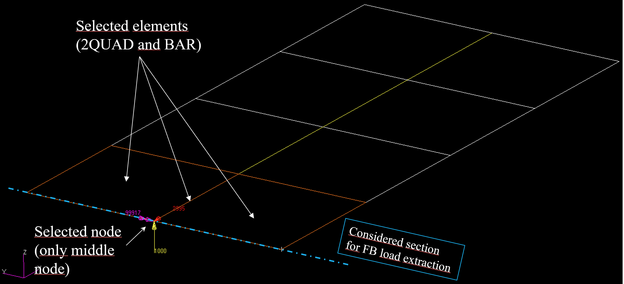

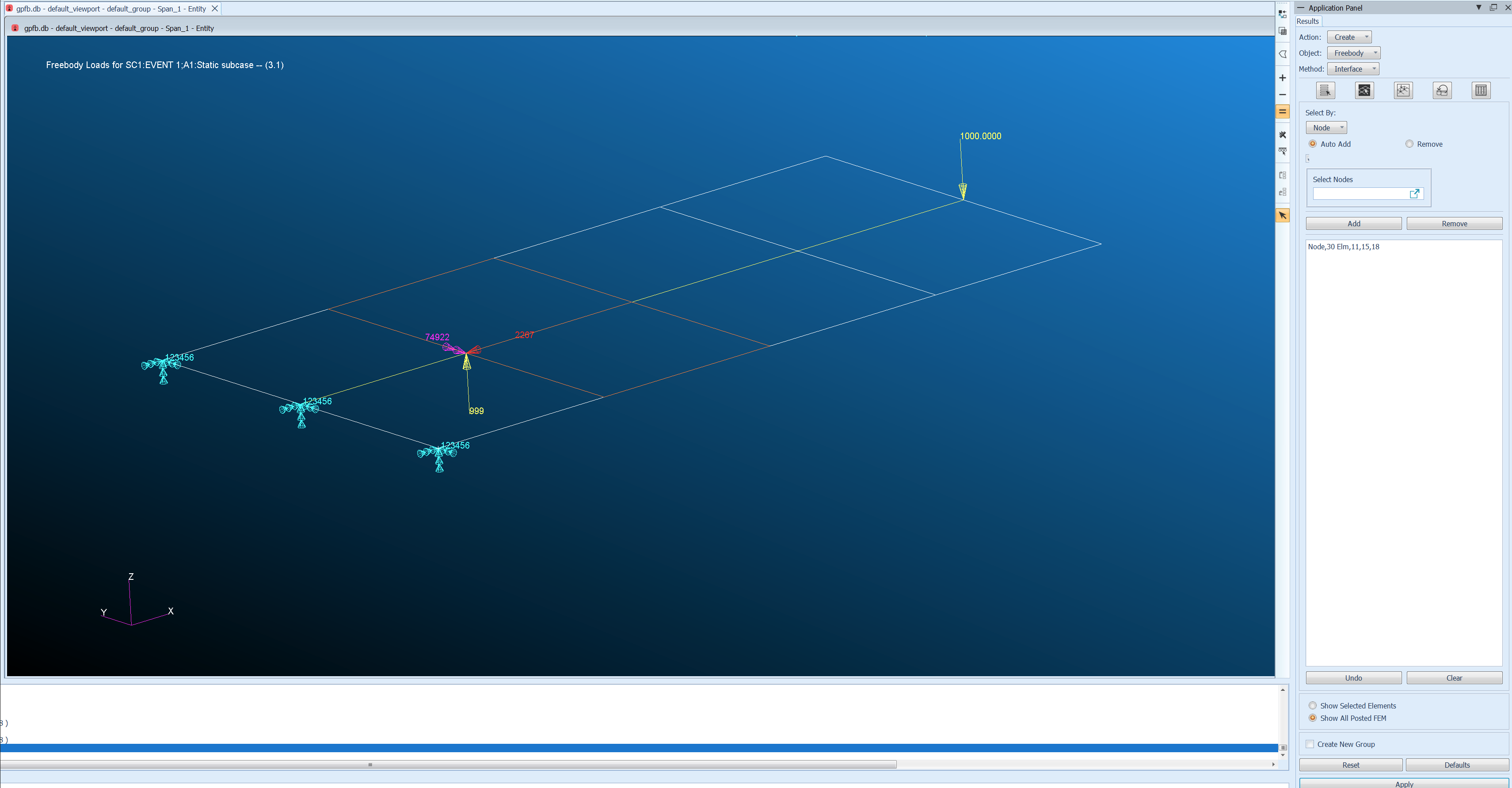

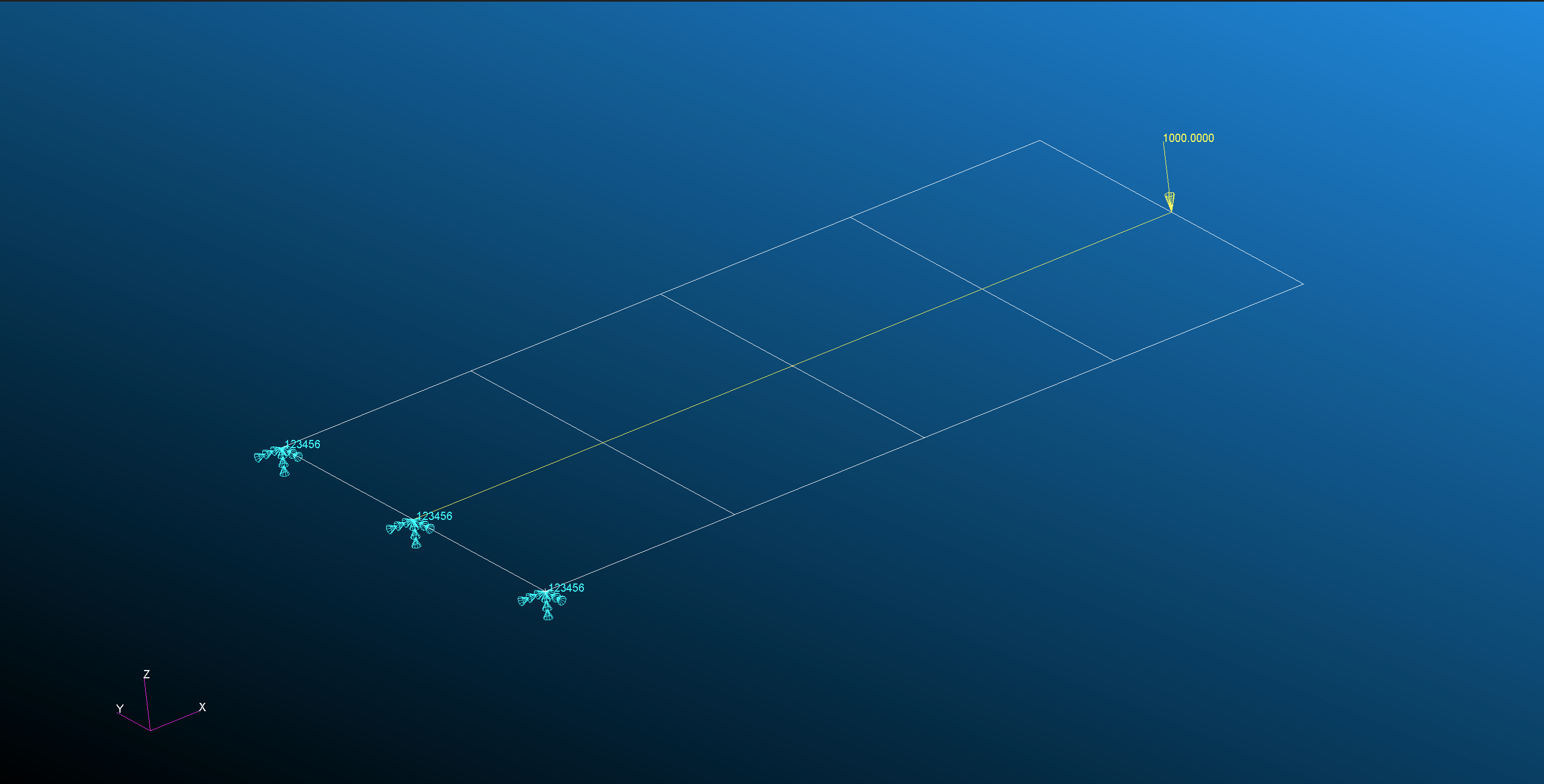

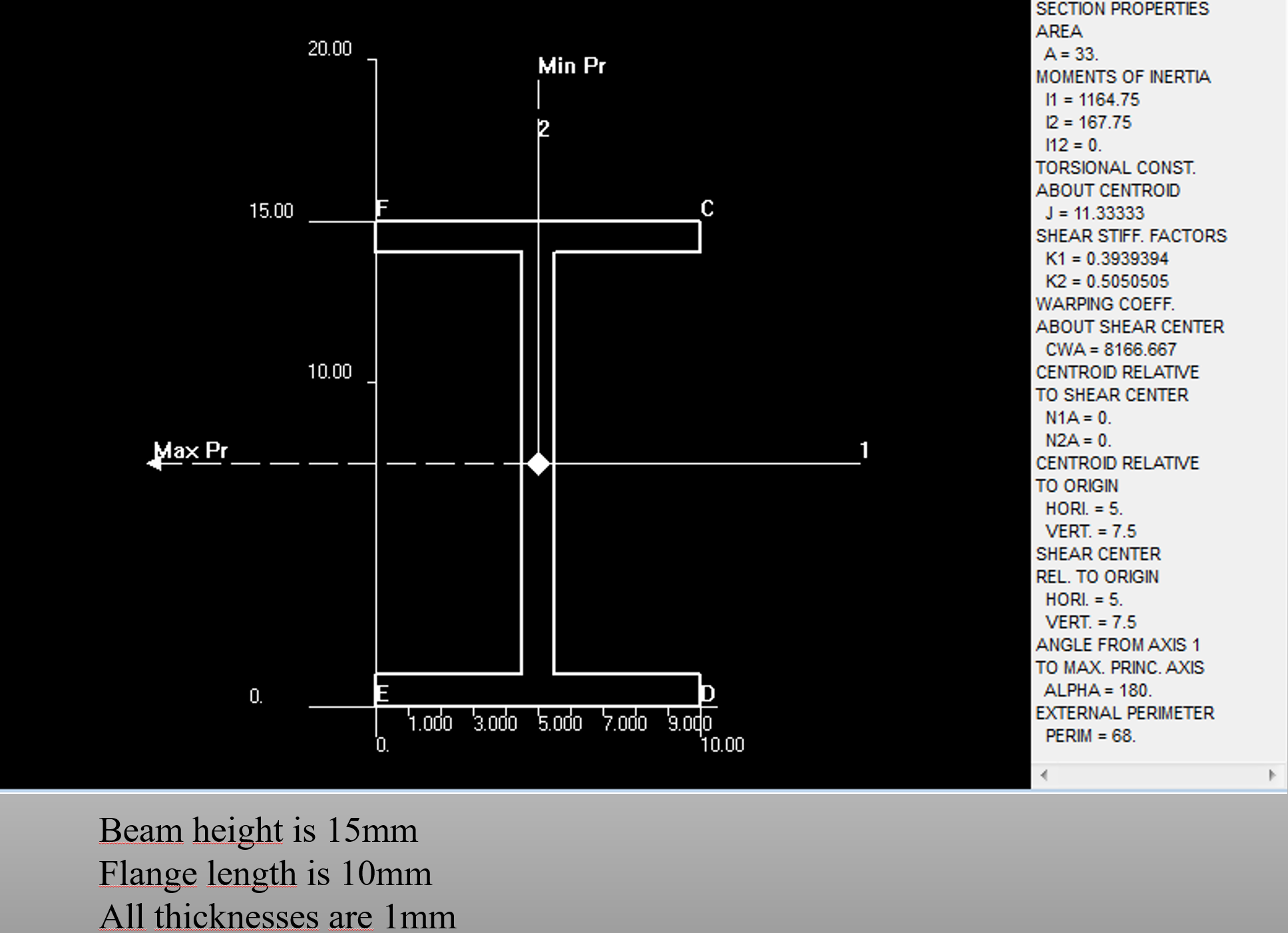

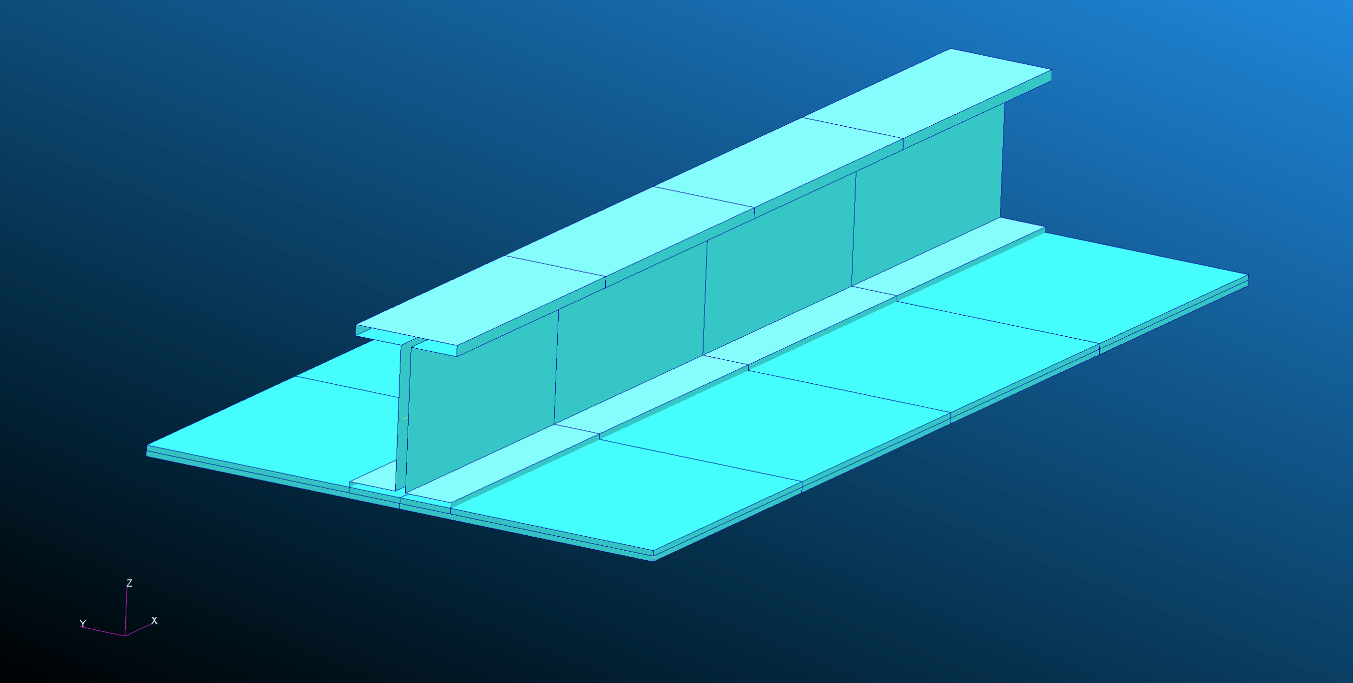

SubscriberThank you for your reply and interest. First, let me give you some information about the model I prepared:Plate size is 50x100x1mm
Element size is 25mm
Material allowables for all:
Young’s Modulus is 70000MPa

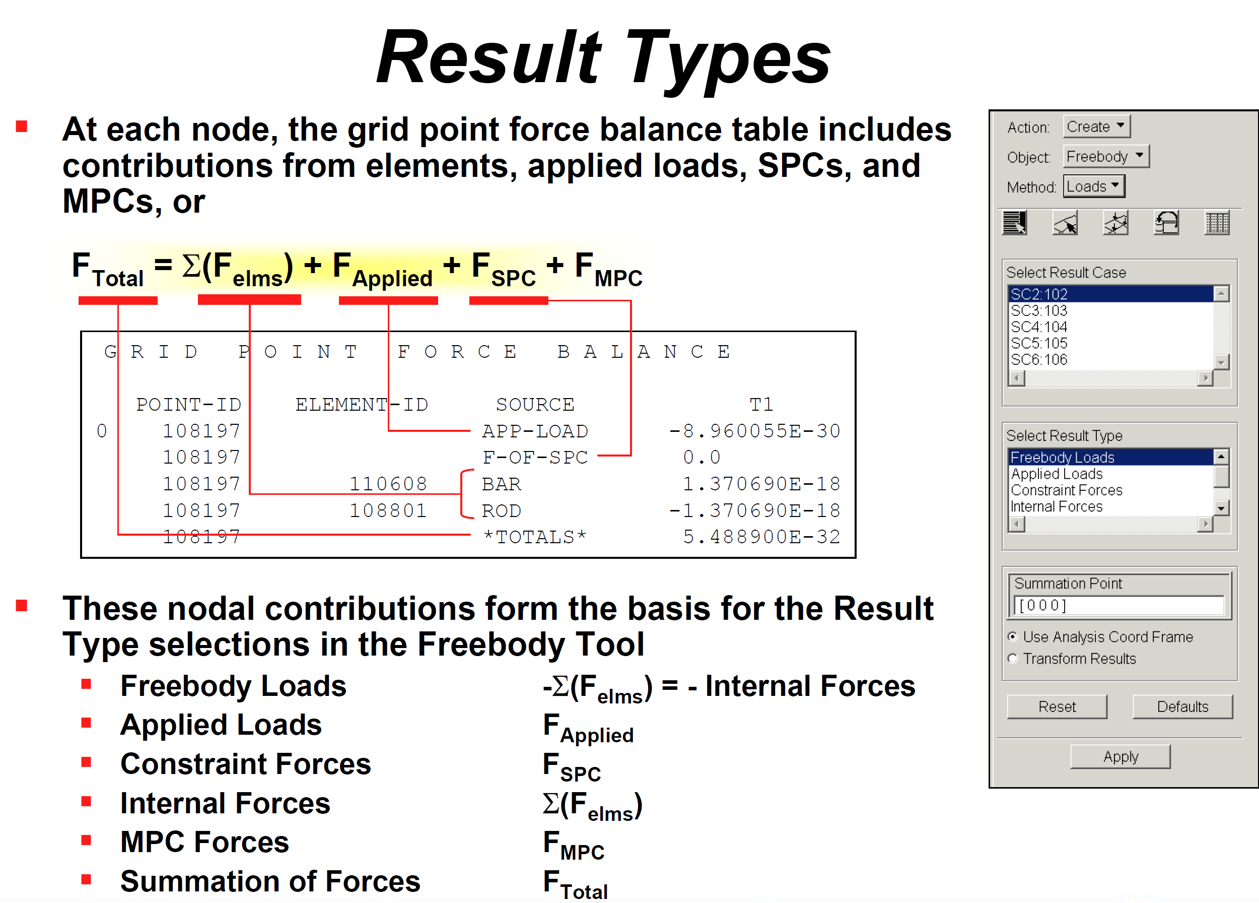

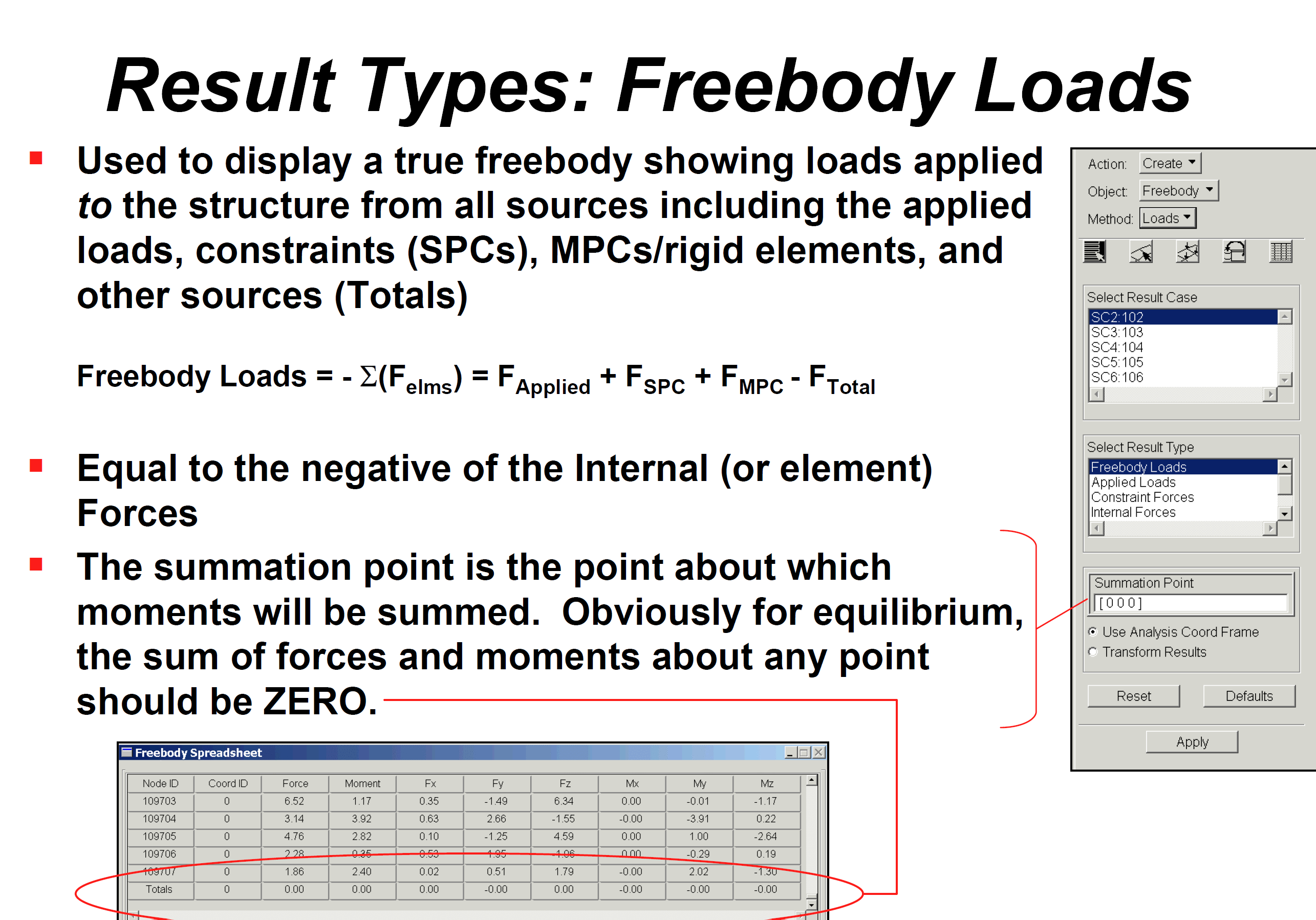

ÂAs you said, we can read the reaction force from any node we want. When we get the GPFB output in Nastran, we get 2 force and 1 moment values. When we get these, we select the 2 shell elements and 1 node element in front of the node from which we want to get the GPFB, and calculate the GPFB. As a result, it gives us the normal reaction force, the bending moment, and the force in the x-direction.ÂÂÂIn Ansys, we could only read this where we kept it as afixbecause in thefixlocation, there were only 2 shell elements in front of the selected node, and it gave the same result as Nastran. However, when we wanted the same output for the node one node in front of thefixlocation, we could not get the same result with Nastran. Also, we used APDL to obtain these results. Is it possible to create the model I attached in ANSYS and obtain these values ​​from the nodes in the results I attached?
Thank you.Â

e195027
SubscriberHi,
Thank you for your reply.

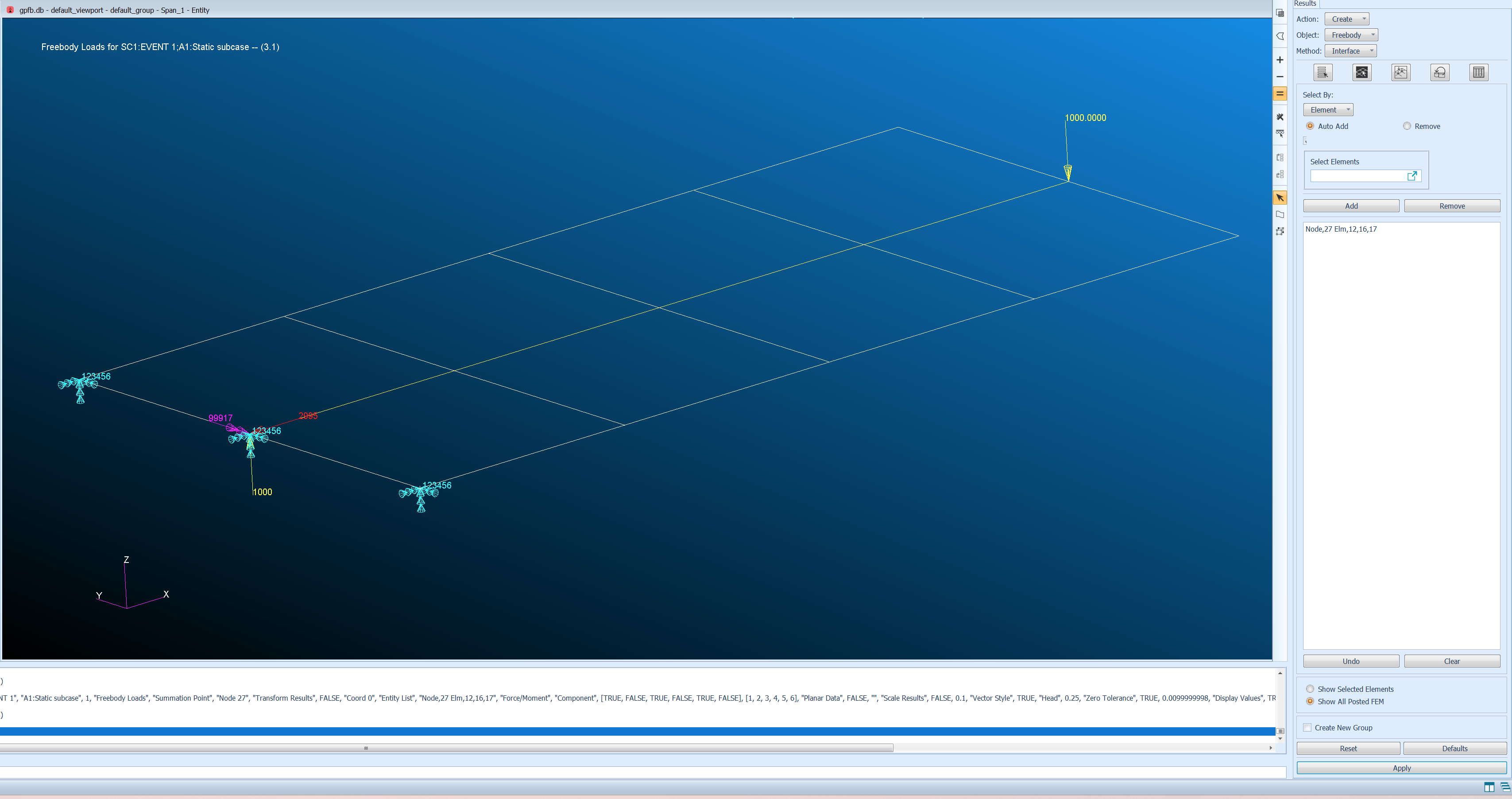

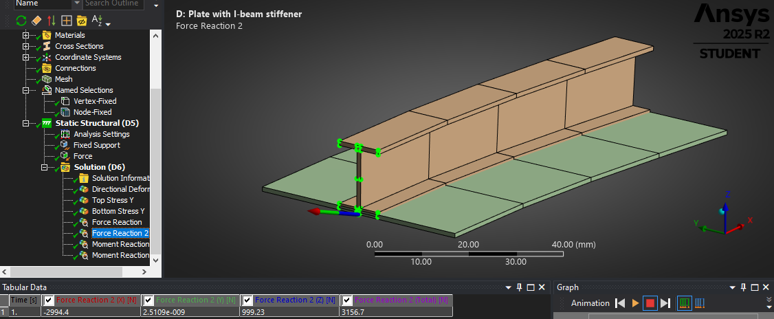

As said before, we can get same results at fixed support but for the node in front of the fixed support we cannot get the same results Nastran. I dont want to get reaction force, I need GPFB at a specific location.
Here is the ANSYS results in front of the fixed support node;

e195027

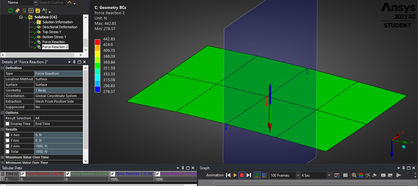

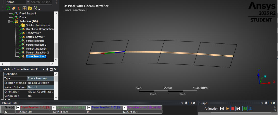

SubscriberWhile using the force reaction and moment reaction with surfaces, we cannpt select plate body and 1-D beam body at the same time.
February 17, 2026 at 4:30 pm

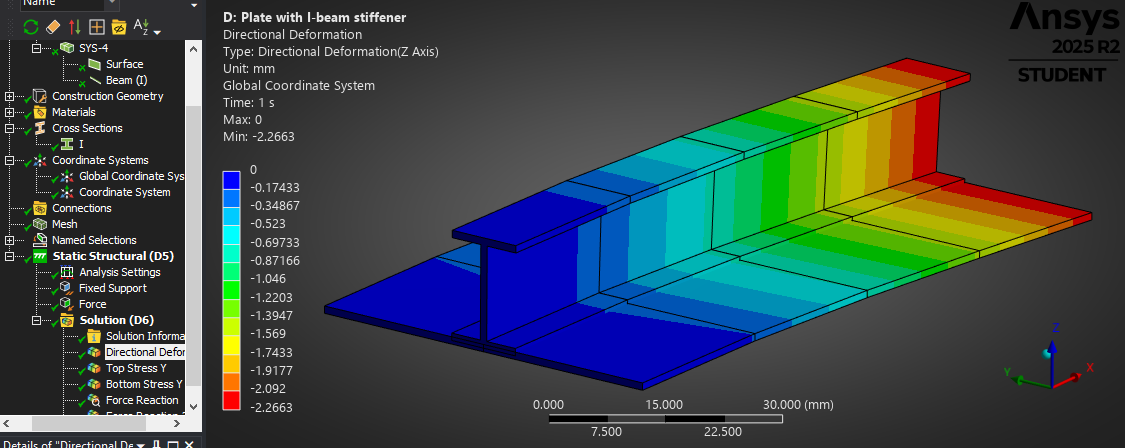

peteroznewman

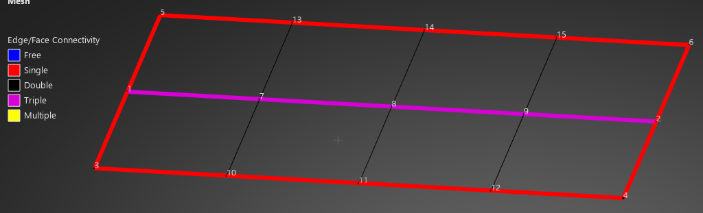

SubscriberPlot the Directional Deformation on your model and I think it will become clear that your shell and beam elements are not connected. They are both supported at the fixed end, but seem to not be connected at the free end and the force is only applied to a node on the beam element while there is a coincident node on the shell element that has no load.
Look at the deformed shape where the beam is passing through the plate. If you change the sign on the Force, you will see those two bodies separating instead of penetrating.
One corrective action in your model is to insert under the Mesh a Node Merge Group type a tolerance value to equivalence the nodes and Generate the result. Now when you solve, you should see the beam and shell elements moving together on shared nodes. I accomplish the same result by using the Share button in SpaceClaim to tell the Ansys mesher to share nodes instead of create coincident nodes. Here is my mesh with the nodes turned on.
When I insert a Force Reaction at Node 7, Ansys reports a near zero value because it sums up the forces from all elements attached to that node and is should sum to near zero.
Now I haven't lost sight of your original question, I understand you want a table that breaks down the forces coming from the beam elements in one bucket, and the forces coming from the shell elements in another bucket (or something like that), so I will try to address that in my next reply.Â
Please reply with the Nastran .dat or .bdf lines that represents the model you described above. I will take a look at the Nastran output. Format the Nastran lines of text in your reply using the Preformated setting instead of the default Paragraph (accessible in the toolbar at the bottom of the reply) in order to skip turning each line into a Paragraph.
February 17, 2026 at 9:42 pm
peteroznewman

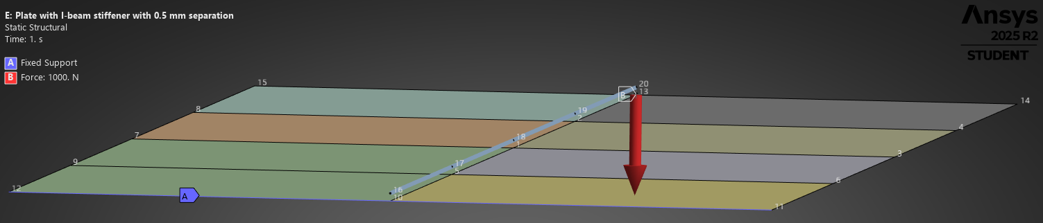

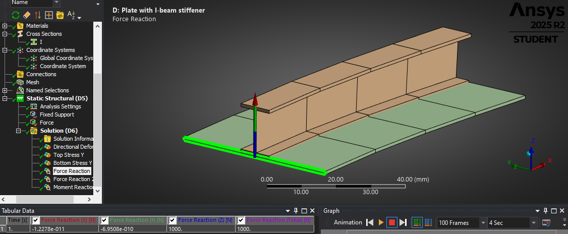

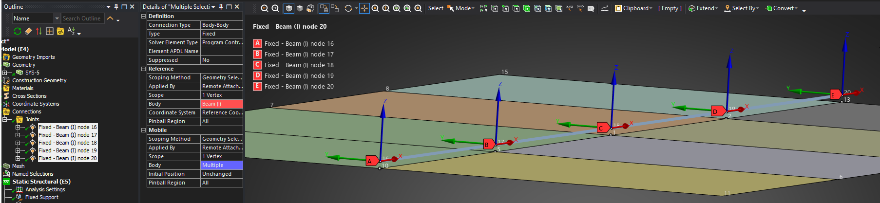

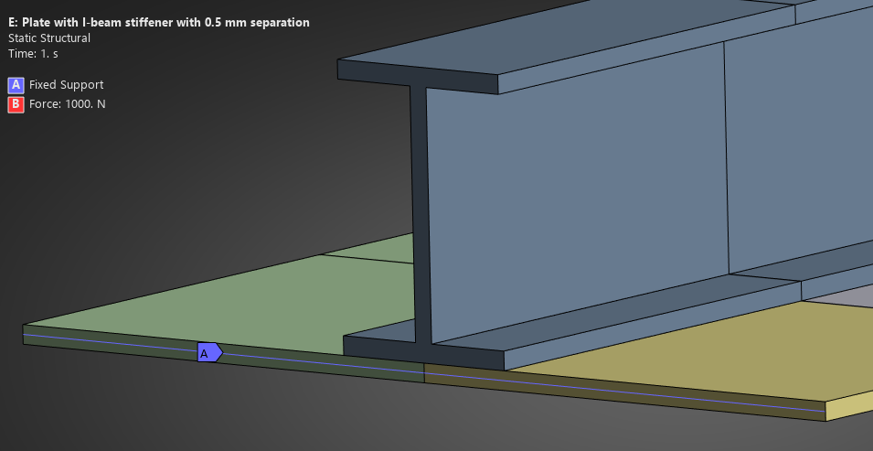

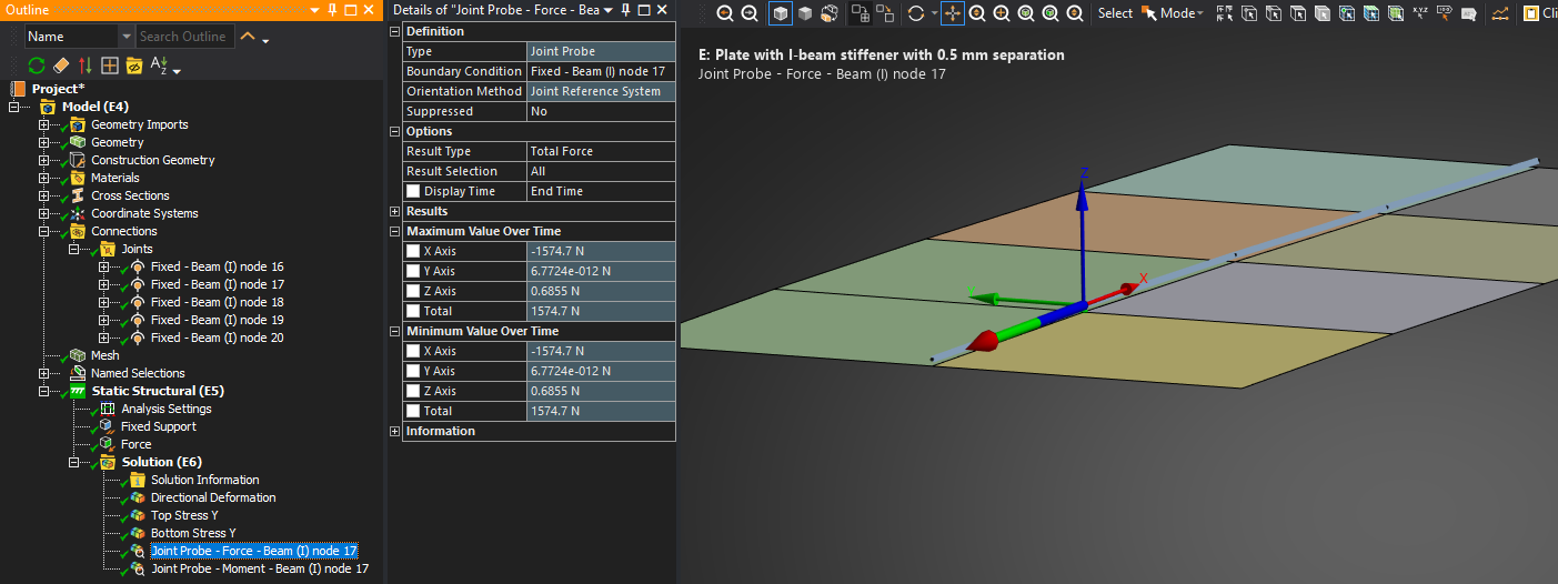

SubscriberAnother observation on your Nastran model is that the shell elements have half their thickness above the node and half below, while the I-beam profile is only above the node. In reality, the stiffner sits on the top face of the plate, so it would be more accurate to offset the shell element by 0.5 mm to have it connect to the I-beam at the correct height.
In the next version of the Ansys model, I moved the plate down by 0.5 mm so that the stiffener is now located above the plate thickness instead of halfway through the thickness.
When I turn off Thick Plates and Shells, you see that the plates have nodes along the center and the beam has separate nodes above the plate nodes.

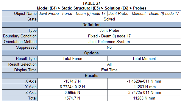

I used what Nastran would call an RBE2 element and Ansys calls a Fixed Joint to connect the five pairs of adjacent nodes.
After solving, I can extract the forces and moments going through each joint element. Here is the result for the force going through node 17 at flag B above.
Ansys has a Report Preview on the Home tab where a table of all the Probes with the results is listed.
You can get all 5 joints if you want.

here is the bdf file :
$ $ Created by MSC Apex Version 2024.2 on Feb 13, 2026 at 19:19:12
$ Values exported in this file are expressed using the consistent SI_mm_t_deg
$ unit system
$ Â Length mm
$ Â Mass t
$ Â Time s
$ Â Force N
$ Â Temperature K
$ NOTE: Nastran requires the following angle values always be defined in
$ degrees, while all other rotational quantities will be defined in terms of
$ radians
$ PCOMPG Â (THETAi - ply orientation angle)
$ TABLED1 (yi - phase angle data when referenced in TP field of RLOAD2)
$ Linear Static Scenario Static Scenario Model Assembly
$ Scenario description
SOL 101
CEND
PARAM,AUTOMSET,AUTO
$ Automatic Stiffness Singularity Constraints
AUTOSPC(NOPRINT) = YES
ECHO=NONE
$ Output Requests
DISPLACEMENT(PLOT) = ALL
STRESS(PLOT,VONMISES,CORNER) = ALL
OLOAD(PLOT) = ALL
SPCFORCES(PLOT) = ALL
GPFORCE(PLOT) = ALL
MPCFORCES(SORT1,PLOT) = ALL
$ Event name: Event 1
$ Event description:
SUBCASE 1
 SUBTITLE=Event 1
 $ Output Requests
 STRESS(PRINT,PLOT) = ALL
 GPSTRESS(PRINT,PLOT) = ALL
 FBODYLD = ALL
 GPFORCE(PRINT,PLOT) = ALL
 SPC = 1
 LOAD = 1
BEGIN BULK
$ HDF5 Results file
MDLPRM,HDF5,1
$ Parts & Assemblies contained in Assembly Model_12
$ Part Part_1
$ Â Â Â 2 Â Â Â 3 Â Â Â 4 Â Â Â 5 Â Â Â 6 Â Â Â 7 Â Â Â 8 Â Â Â 9 Â Â Â 0
$ Elements for Beam Span: Span 1
CBEAM Â 17 Â Â Â 170 Â Â 27 Â Â Â 30 Â Â Â 0. Â Â Â -6.12-14-1000. Â BOO Â Â +
+ Â Â Â Â Â Â Â Â Â Â Â 0. Â Â Â -7.5 Â Â 0. Â Â Â 0. Â Â Â -7.5 Â Â 0.
CBEAM Â 18 Â Â Â 170 Â Â 30 Â Â Â 29 Â Â Â 0. Â Â Â -6.12-14-1000. Â BOO Â Â +
CBEAM Â 19 Â Â Â 170 Â Â 29 Â Â Â 28 Â Â Â 0. Â Â Â -6.12-14-1000. Â BOO Â Â +
CBEAM Â 20 Â Â Â 170 Â Â 28 Â Â Â 26 Â Â Â 0. Â Â Â -6.12-14-1000. Â BOO Â Â +
CQUAD4 Â 9 Â Â Â 169 Â Â 21 Â Â Â 26 Â Â Â 28 Â Â Â 22
CQUAD4 Â 10 Â Â Â 169 Â Â 22 Â Â Â 28 Â Â Â 29 Â Â Â 23
CQUAD4 Â 11 Â Â Â 169 Â Â 23 Â Â Â 29 Â Â Â 30 Â Â Â 24
CQUAD4 Â 12 Â Â Â 169 Â Â 24 Â Â Â 30 Â Â Â 27 Â Â Â 25
CQUAD4 Â 13 Â Â Â 169 Â Â 26 Â Â Â 19 Â Â Â 18 Â Â Â 28
CQUAD4 Â 14 Â Â Â 169 Â Â 28 Â Â Â 18 Â Â Â 17 Â Â Â 29
CQUAD4 Â 15 Â Â Â 169 Â Â 29 Â Â Â 17 Â Â Â 16 Â Â Â 30
CQUAD4 Â 16 Â Â Â 169 Â Â 30 Â Â Â 16 Â Â Â 20 Â Â Â 27
GRID Â Â 16 Â Â Â Â Â Â Â 25. Â Â 0. Â Â Â 0.
GRID Â Â 17 Â Â Â Â Â Â Â 50.005 Â 0. Â Â Â 0.
GRID Â Â 18 Â Â Â Â Â Â Â 75.01 Â 0. Â Â Â 0.
GRID Â Â 19 Â Â Â Â Â Â Â 100. Â Â 0. Â Â Â 0.
GRID Â Â 20 Â Â Â Â Â Â Â 0. Â Â Â 0. Â Â Â 0.
GRID Â Â 21 Â Â Â Â Â Â Â 100. Â Â 50. Â Â 0.
GRID Â Â 22 Â Â Â Â Â Â Â 75. Â Â 50. Â Â 0.
GRID Â Â 23 Â Â Â Â Â Â Â 49.995 Â 50. Â Â 0.
GRID Â Â 24 Â Â Â Â Â Â Â 24.99 Â 50. Â Â 0.
GRID Â Â 25 Â Â Â Â Â Â Â 0. Â Â Â 50. Â Â 0.
GRID Â Â 26 Â Â Â Â Â Â Â 100. Â Â 25. Â Â 0.
GRID Â Â 27 Â Â Â Â Â Â Â 0. Â Â Â 25. Â Â 0.
GRID Â Â 28 Â Â Â Â Â Â Â 75. Â Â 25. Â Â 0.
GRID Â Â 29 Â Â Â Â Â Â Â 49.995 Â 25. Â Â 0.
GRID Â Â 30 Â Â Â Â Â Â Â 24.99 Â 25. Â Â 0.
$ Material Record: mm
MAT1 Â Â 1 Â Â Â 70000. Â Â Â Â Â .33 Â Â 2.7-9
$ Elements and Element Properties for Section: Span_1
$ Beam properties of Beam Span: Span 1
PBEAML Â 170 Â Â 1 Â Â Â Â Â Â Â I1 Â Â Â Â Â Â Â Â Â Â Â Â Â Â Â Â Â Â Â +
+ Â Â Â 9. Â Â Â 1. Â Â Â 13. Â Â 15.
$ Elements and Element Properties for: 2D_Element_Property_3
PSHELL Â 169 Â Â 1 Â Â Â 1. Â Â Â 1 Â Â Â Â Â Â Â 1
$ Static Force: Force 3
FORCE Â 1 Â Â Â 26 Â Â Â Â Â Â Â 1. Â Â Â Â Â Â Â Â Â Â Â -1000.
$ Single-Point Constraint, Alternate Form: Constraint 2
SPC1 Â Â 1 Â Â Â 123456 Â 20 Â Â Â 25 Â Â Â 27
BCPARA Â 0 Â Â Â METHOD Â SEGTOSEGNLGLUE Â 0
ENDDATAhere is the F06 result filethat you can see the GPFB results :

we are dealing with "FREEBODY LOADS".Â
