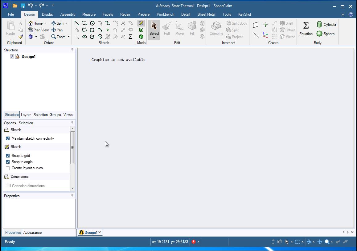

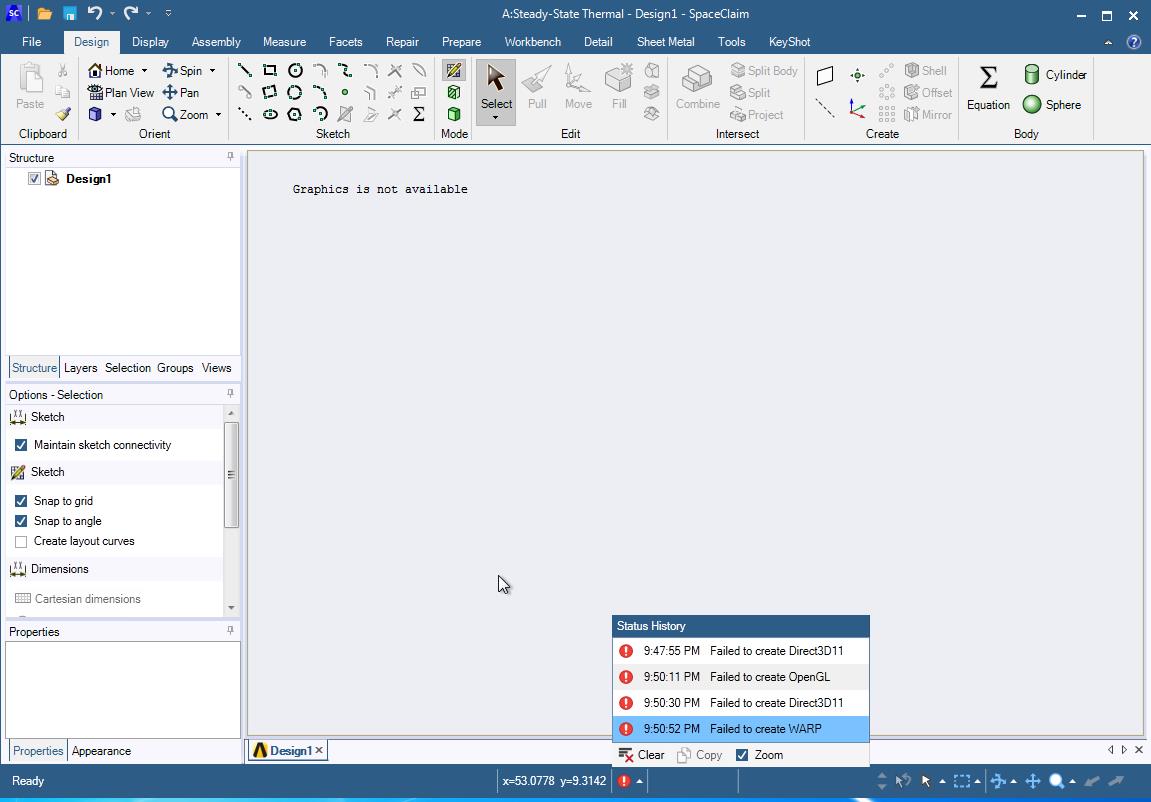

      I installed ansys 20 and I ran spaceclaim and got this error and after this I even changed settings in advance tab still error is coming plz help (I'm using windows 7 professional in Virtualbox installed in MacBook Air )

      VirtualBox is probably not good enough to pass graphics to the Guest OS (Windows in this case). You should find a physical machine hosting Windows OS. Or you can try Parallels or Bootcamp but I can't guarantee that it will 100% work as VM on MacOS is not officially supported.
