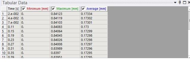

      I have defined the auto time stepping on but in results, I don't see the effect of gradual load increment. and what settings I need to make to see this effect.
      IAnalysis SettingsResults Observed
      I see the effect.
      Initial substeps of 50 or time inc. of 1/50 = 0.02 s and the first and second time steps are at 0.02 and 0.04 s.
      Minimum substeps of 25 or time inc. of 1/25 = 0.04 s and the difference between steps 4 and 5 is 0.04 s.
      I hope you now see the effect too.
