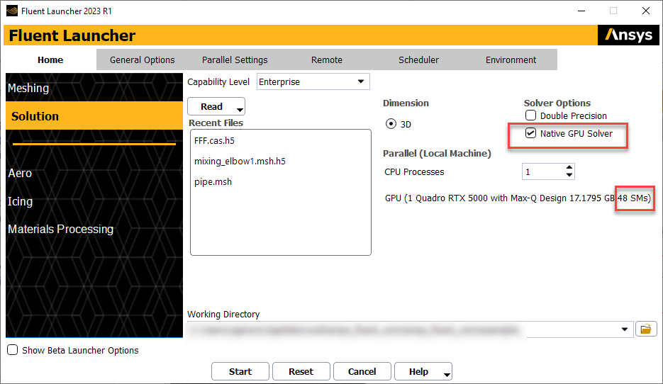

      If you have a GPU card with less than or equal to 40 SMs, GPU computing on Fluent via student product can be used. See the snapshot below taken from my machine showing the number of SMs available on GPU card. Since I have 48 SMs, GPU computing on Fluent via student product is not supported.
