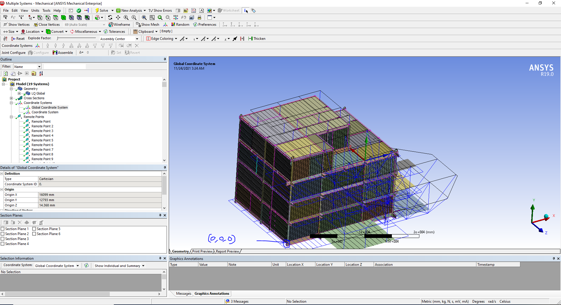

SubscriberPlease see the below image.
Originally Global Coordinate system is at 0,0,0, location.
Yesterday when i was creating remote points, somehow the location of 'Global Coordinate System' got changed. i dont know how and why it happened, it was not intentional. (even the orientation got changed)
Kindly help me in moving back to the original position and orientation.

Ansys EmployeeRight click on Model branch and insert part transform. Then transform the model using the part transform details
Or move the geometry in Design Modeler or Spaceclaim or CAD system

Model is there only its 0,0,0 location did not change, but the Global Coordinate system changed its location. Still do you want me to try this option?
November 26, 2021 at 1:21 pmGovindan Nagappan
Ansys EmployeeFor any coordinate system, its origin is always 0,0,0
If the model is in relatively wrong position compared to the coordinate system, you can move the model as needed
